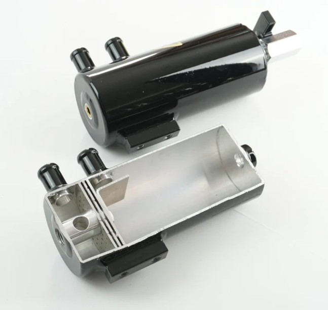

Good catch cans generally aren't cheap because there is a fair amount of development time in making effective baffling. Lots of guys stuff steel wool in empty cans and wonder why they still have crankcase pressure issues.
There is a balance between flow and filtration, good flow helps evacuate pressure better but too much filtration can kill flow. The cans we use have a diverter plate behind the inlet port to force the incoming gases to go to the bottom of the can and then they have to flow upwards through a triple baffle plate system. Also, people tend to be willing to pay a bit more for a bolt on solution versus buying a universal product and cobbling together a way to make it fit. I've debated making an Evo kit but not sure if there's much market for it.

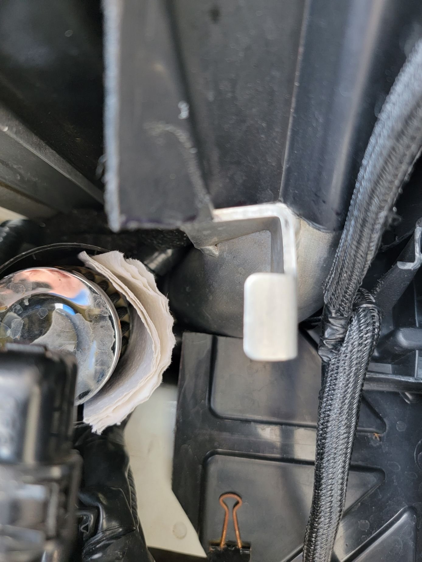

@Stev-o-evo For our cars, you primarily want to prevent oil from going into the intercooler/piping. easy fix is this model, its long(also baffled) and fits the gap between the IC piping and the radiator mounting frame whatchumallit) you can cap the top and ziptie it to the IC piping. if you want you can add an extend hose so its easier to drain. use silicon hoses so it could be routed easiily
https://www.ebay.com/itm/204156990689
my system is oil-catch-&-return then finally vent-to-air(this is that final stage) ... before my rebuild I was worried about extracting too much oil and I want a lower maintenance solution. for me this catch can gets mostly water, but has a little oil
only pic i have of mine - sorry about the paper towel, i was trying to see if oil spews out. btw i added a spray paint cap around the breather.
I suggest to start cheap until you have an understanding of the issue you want to solve.

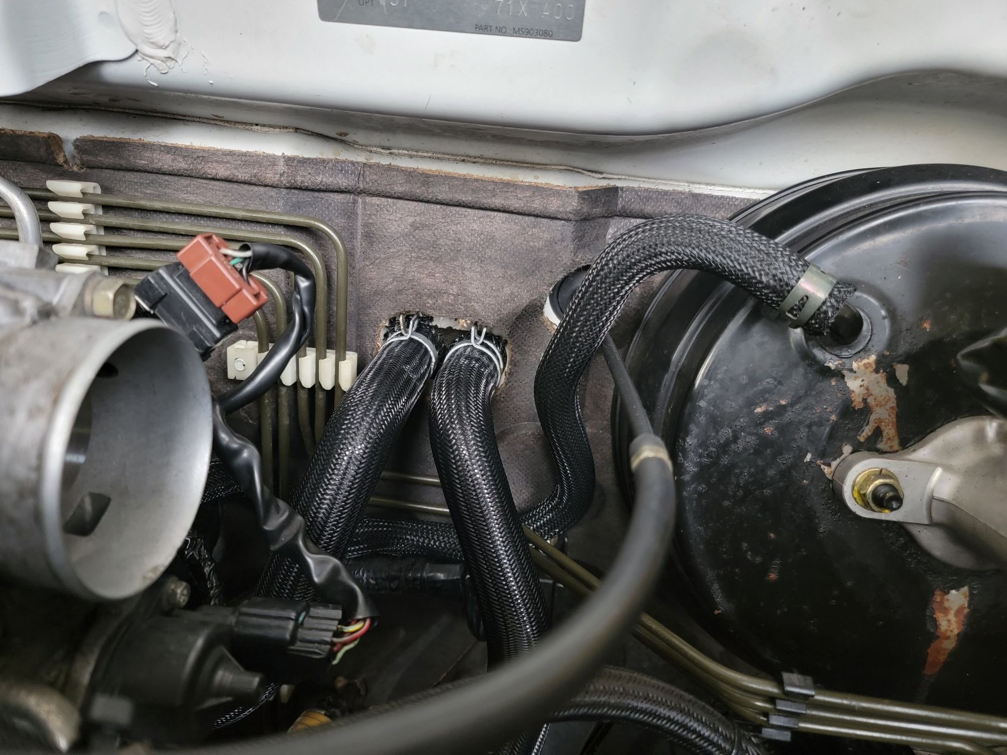

yup thats the best area for oil drain back also as long as its high enough for the dipstick. Also makes sure the catch can isnt in the way for even dropping the transmission.

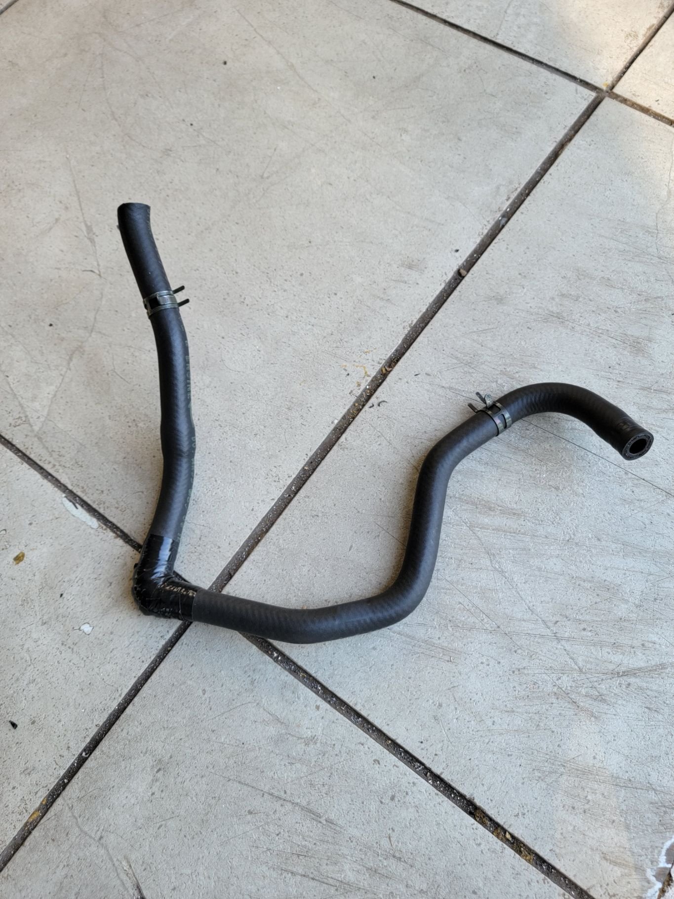

here's the modified vacuum hose I made to make space. I use the EVAP vacuum port now.
