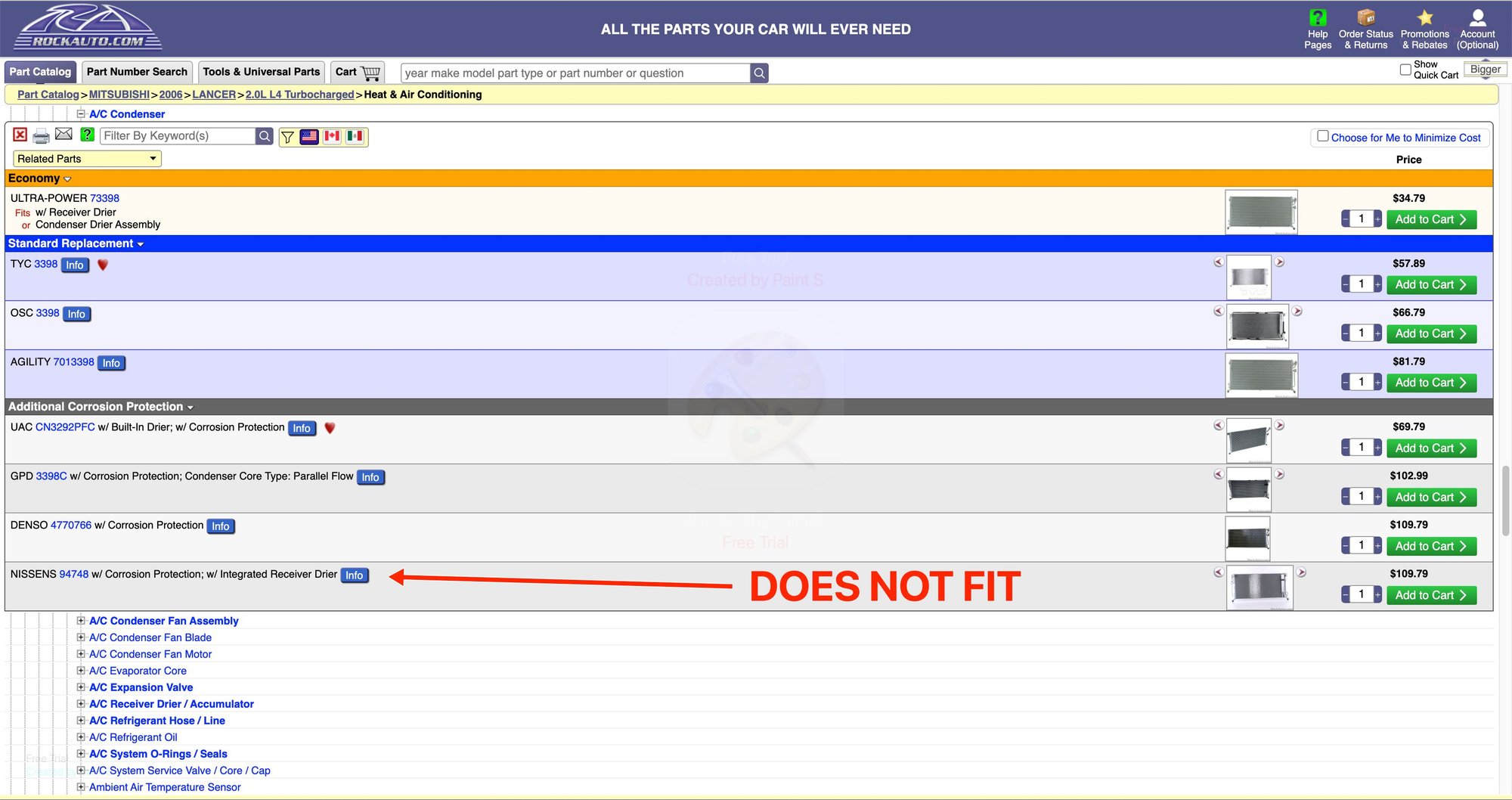

Nissens 94748 AC Condenser Does Not Fit CT9A
I'm making this post to warn anyone else who is replacing their AC condenser. RockAuto lists the Nissens P/N 94748 AC condenser as compatible with our cars. It is not. The bottom rubber feet on the condenser line up with the core support, but the bolt holes in the top corners of the condenser do not. The label on the box says "compatible with Mitsubishi Lancer (2001)".
I purchased the UAC condenser and will be test fitting it when it arrives. I will report back.
