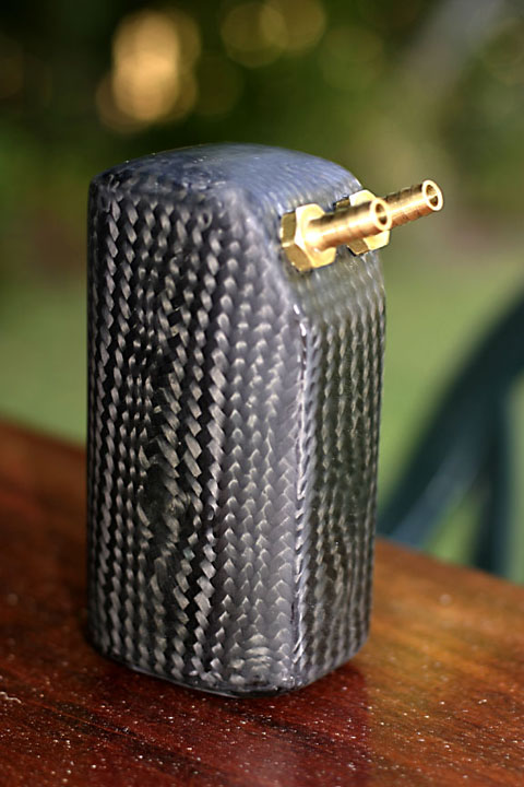

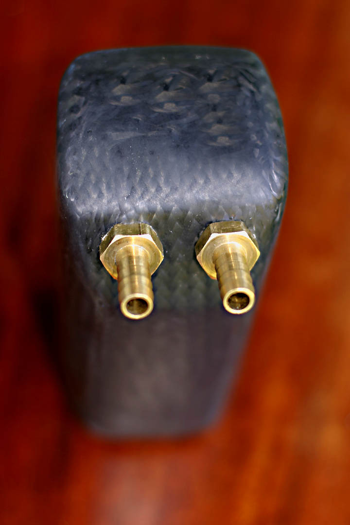

Threw this together:

pretty cool....what did you use as a mold...or did you cover something?

lost foam process and then giant perforated heat shrink + vacuum bag for dry carbon with a 5 bar vacuum pump...

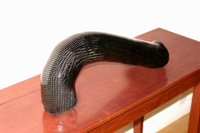

the key to seamless parts is carbon fiber sleeving. I made a 4" carbon cold air intake with the sleeving:
When you used the sleeving, how did you cleanly close off the ends? or did you lay up a piece of sheet material to make a bottom? Thanks a lot for the links! They were very helpful...(I'm wondering the same question for the nose of that little plane, actually).
