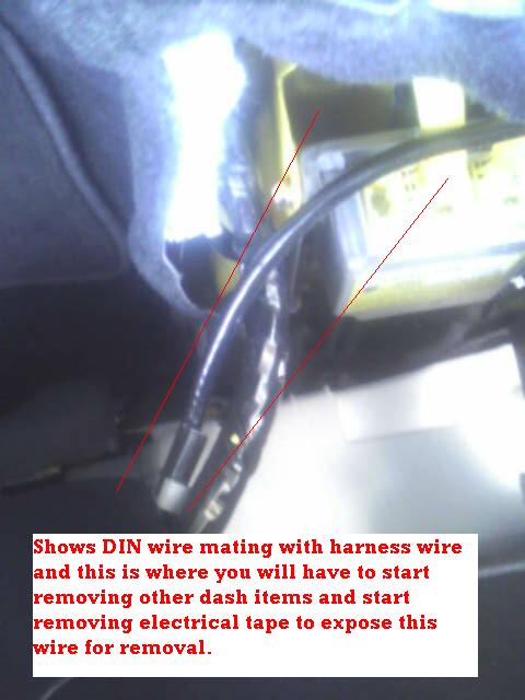

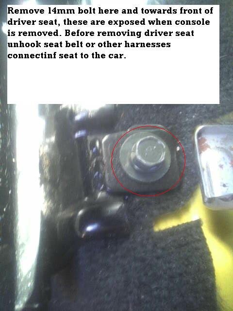

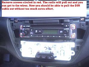

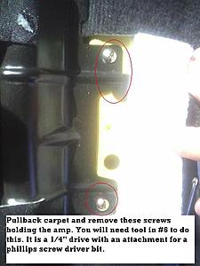

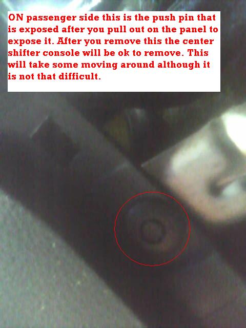

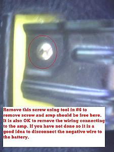

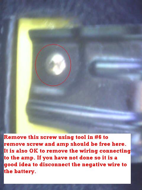

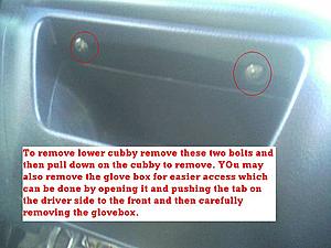

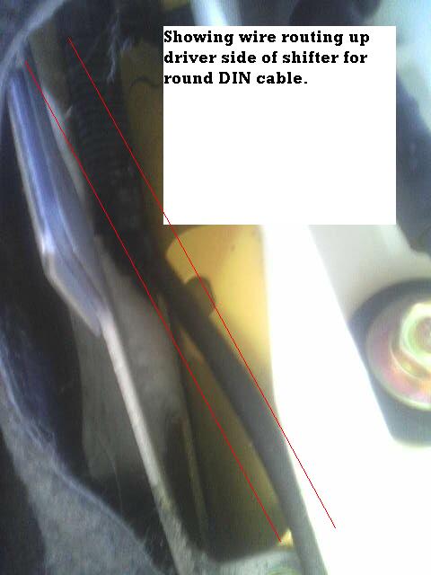

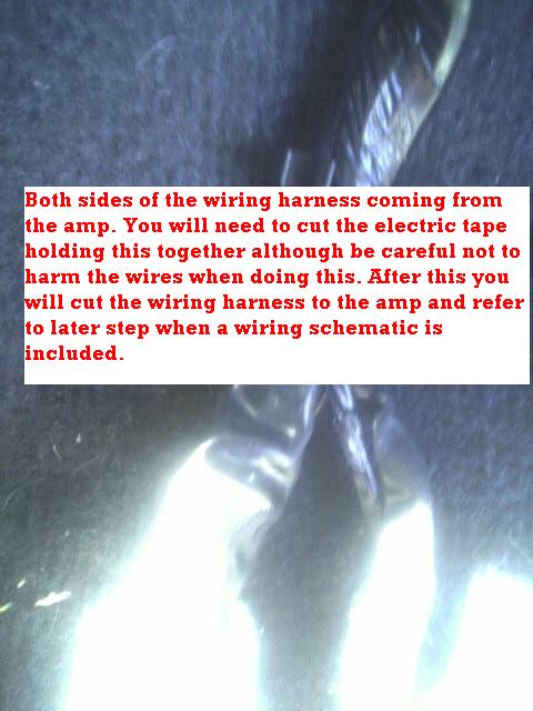

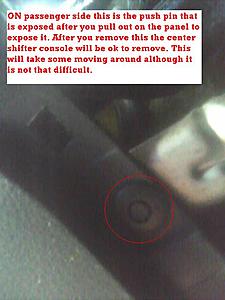

MODS: There is more to add to this. I will not be able to finish it through Sunday 9/25. Please do not move or close it until then.

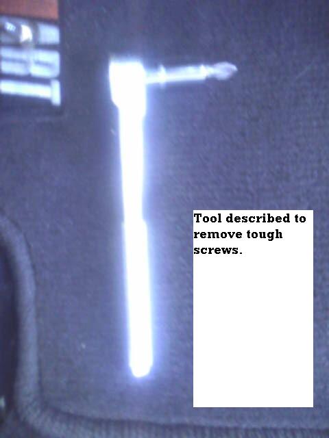

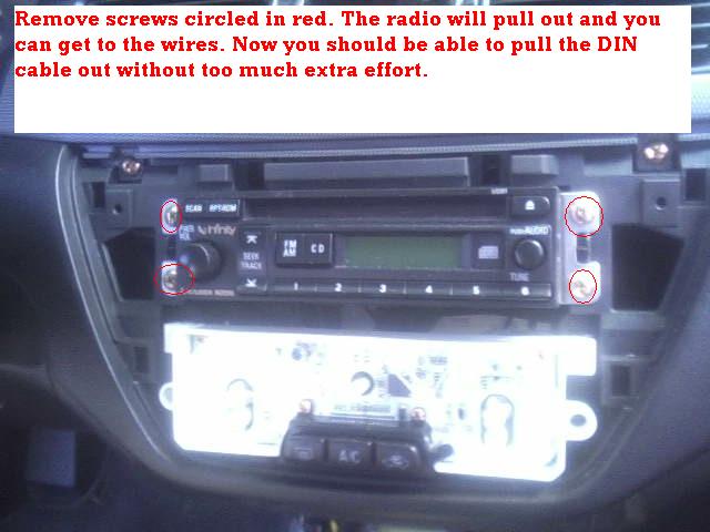

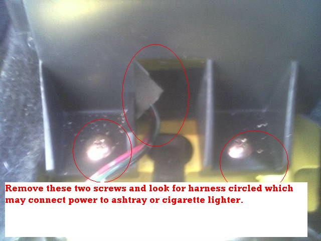

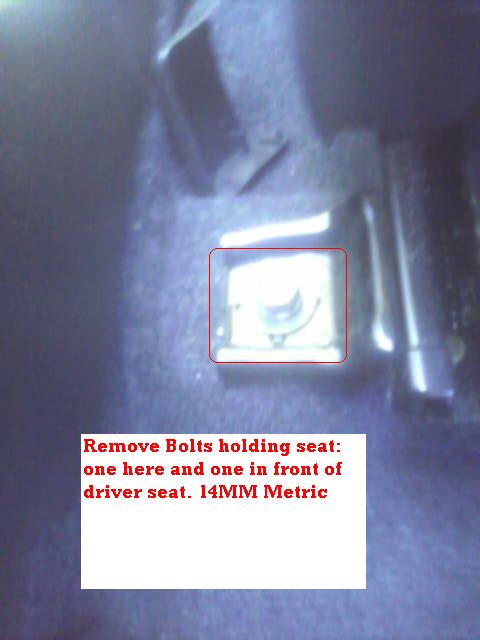

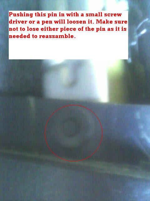

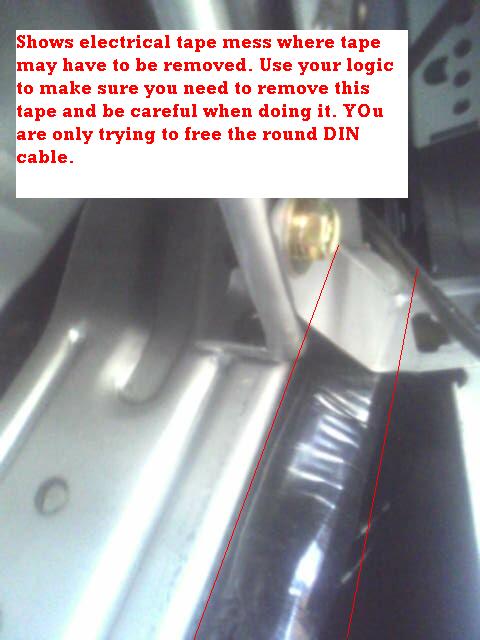

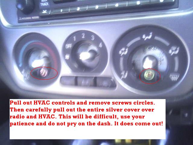

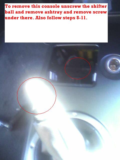

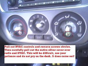

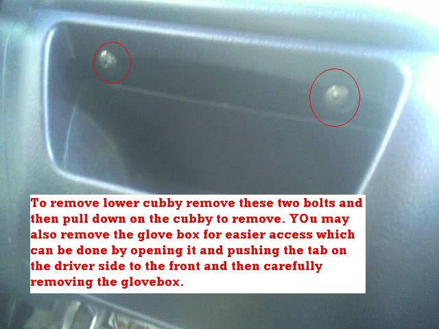

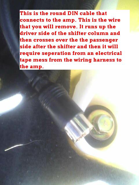

These pictures will describe in the best of my ability in how to remove the factory Infinity sound package from an EVO/Ralliart. I have more pictures to add and the descriptions could be a bit more detailerd but this should show you 90% of the process.
Attached Thumbnails Removing factory Infinity System-1.jpg   Removing factory Infinity System-2.jpg   Removing factory Infinity System-3.jpg   Removing factory Infinity System-4.jpg   Removing factory Infinity System-5.jpg

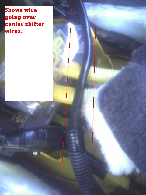

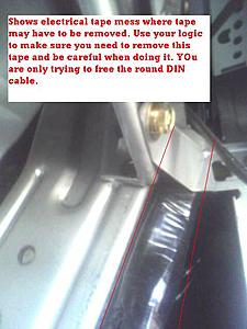

Attached Thumbnails Removing factory Infinity System-6.jpg   Removing factory Infinity System-7.jpg   Removing factory Infinity System-8.jpg   Removing factory Infinity System-9.jpg   Removing factory Infinity System-10.jpg

I am ripping mine out and its a painful process. The tweeter mounts just will not come off and trying to pull the amp DIN connector sucked.
I really hate these screws that are torqued to 100lbs. How the hell do you get screws off like this???
Your better off going aftermarket...
