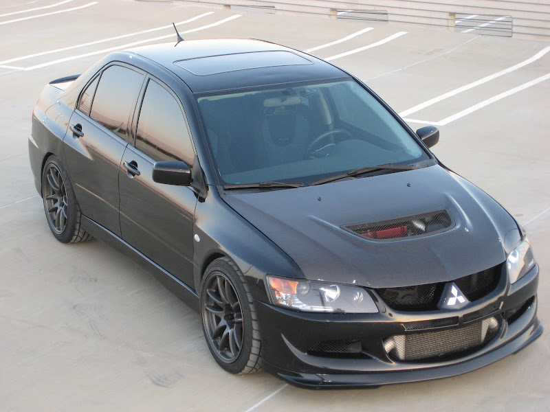

The only question I have is the following -
1. The sunroof appears to have a slight dip in the rear about 1/16" inch down from the roof, can anyone confirm with their sunroof that this is the case after fixing?
I looked back through some old pictures I had of my car and they aren't clear enough to make out the slight dip in the rear of the sunroof seal.
This picture appears to show a slight dip in the rear with the sunroof/seal but I want to make sure.
