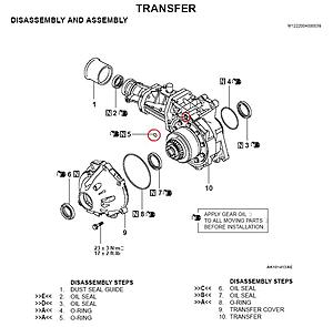

7) Change transfer case cover o-rings (the small o-ring and its’ install location are circled in red above)
