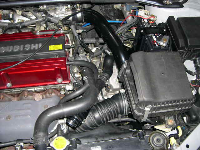

Heres a pic of mine, I just installed my Nisei IC kit this last weekend.
Attached Thumbnails Nisei Upper Intercooler Pipe: Help!-dscn0492.jpg   Nisei Upper Intercooler Pipe: Help!-dscn0495.jpg
