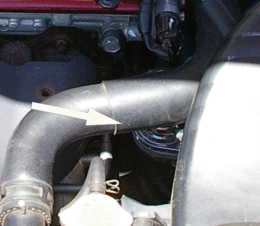

Originally Posted by mrbkkt1
You DO NOT have to remove your radiator hose, but however it is helpful if you install your BOV the correct way not backwards!
This is the OP's BOV install!:
You can clearly see that it is in backwards.
People, If your BOV does not work right, make sure it is installed right!!!!!!!!!

i looked @ it, there is no way it could be on backwards. it is already recirculating back into the intake piping. the hose from the bov to the pipe isn't long enough to relocate it. are you saying that i should mount the bov to the intake tubing, and have the hose somehow magically connect to the tube coming from the turbo?

Believe me it's backwards, unless your own pics are out of date.

This is what my type s looks like installed.
on a side note, i am really excited on how this post turns out since i am not home and used my phone to take the pic, resize the pic, and upload the pic. So if it sucks, let me know or else i will see for myself when i get home.
anyway, you can see how the top of the BOV is facing sideways and not straight up. I don't know how you could have problems w/ making the blowoff valve work this way, it's like an L, and could go either way.
edit: came home and linked the pic to the post.
