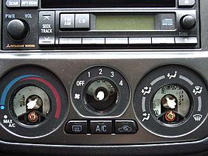

Now, on with the reddening of your evo interior.
There's a very simple method of making all lights red: just remove the blue condoms on the lightbulbs, paint them red with a suitable paint marker, et voila.
Unfortunately this makes the blue band in the HVAC control panel fade badly. We don't want this to happen.
Radio bulbs may indifferently be painted red or covered with red film. Red film is more uniform with the HVAC panel, but if you find the correct grade of red paint even painting them is OK.
Start with cutting a 4"X10" piece of film and stick it on the other film, actually making a double layer of film.
Now make two rings, one with 70 mm external diameter and 40 mm internal diameter.
The other 55 and 37 mm (ext and int)
Then let's start taking everything apart.

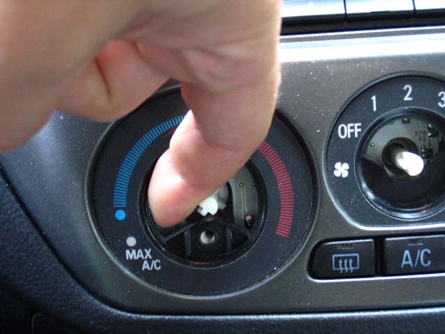

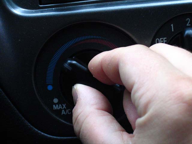

1. Remove HVAC knobs. You just need to pull out. Your hands should be enough, but if you feel pliers are better, use them.

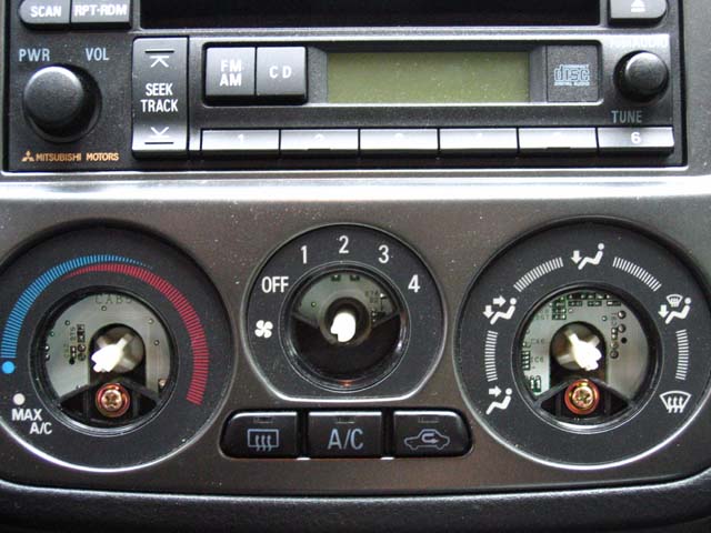

3.
Extract the panel pulling with your fingers from the inside of the knob holes.
This will pull out the lower part of the panel.
Extract the upper part by pulling with your fingers the side of the panel, first on the right side, then on the left.
DO NOT ROTATE UPWARDS! Just pull out.
You need to use some force here.

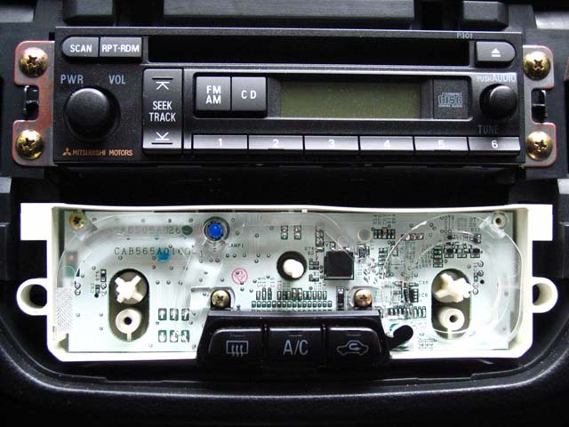

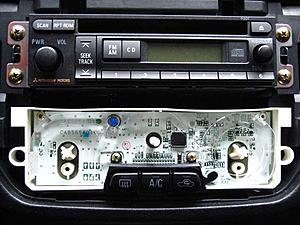

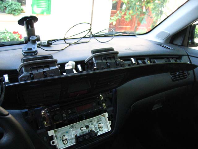

4. by now you'll be facing the "naked" stereo and HVAC panel. The latter has a clear plastic diffuser affixed with 4 screws. You need to unscrew them, taking maximum care to avoid a screw falls inside.
Remove the panel buttons and the diffuser. You'll see two blue things: these are the lightbulbs. Extract them by pulling with some force (DO NOT USE PLIERS! YOU'LL SHATTER THEM!)
Remove the blue condom covering the bulb, and put them in the film box for later use (if you wnat to return the interior lights to their original bluish white, for example).
Put the lamps back in their plugs.

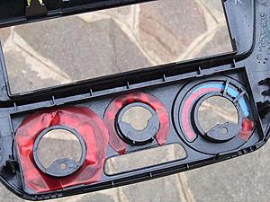

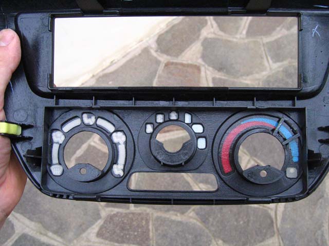

5.
Now for the panel istelf.
Take the red adhesive film rings: you'll notice you'll have to trim them somewhat to adapt them to the inside of the panel. We want one on the flux direction knob ring and one on the flux velocity ring.
Once trimmed to fit, just press them home. Use a small rectangle of double layer film to cover the icon on the lower part of the temperature knob ring.
Once finished it should look somewhat like in the picture (possibly better, I didn't have anything to draw the circles on the back of the adhesive film

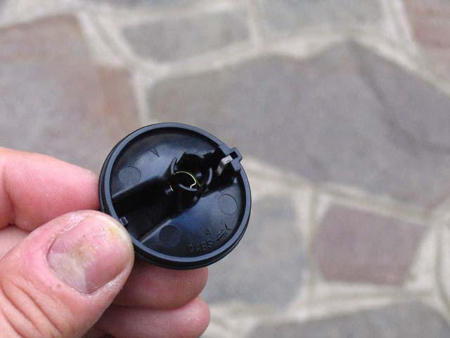

Now we'll redden the knobs: You need the graphic film again, because you can't paint them and get the proper effect.
Just cut two small rectangles of double layered film, and put one on the length of clear plastic IN the knob, and the smaller one, trimmed flush to the surface, on the face of the clear plastic.
Do not use a single piece folded over to cover both surfaces, or it will unstick and your knob light will become yellowish.
Positioning the film here may be tricky, and tweezers may help you.

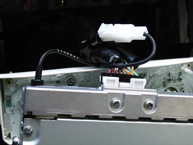

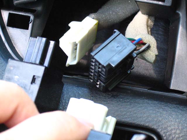

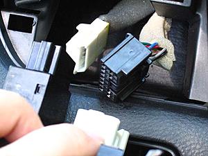

Pull out taking care not to strain the cables. Unlpug the white plug pushing on its release, then unplug the antenna round black plug by twisting it and pulling. It's very tight, and you'll need some force. You may want to use pliers here.
DO NOT PULL ON CABLES: grip the plug itsefl NOT THE CABLES:
Unscrew the 4 screws blocking it to the dash.
TAKE CARE THEY DON'T FALL INSIDE

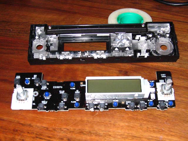

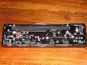

On the bottom side of the car front panel you'll see two tiny screws. USe the precision screwdriver to remove them, taking care to remove them so that they don't fall inside.
BEFORE YOU GO ANY FURTHER, TAKE EVERY MEASURE TO INSURE YOU ARE NOT CHARGED WITH STATIC ELECTRICITY.
WORK ON A WOODEN CHAIR, AVOIDING MOQUETTE ON THE FLOOR, AND TOUCH A TAP OR SOME METALLIC FRAME TO DISCHARGE ANY STATIC ELECTRICITY YOU MAY HAVE ACCUMULATED.
The front panel is now fixed only by the small clamps on the sides. Gently lift one at a time using the small flat scredriver, starting at a side one, and remove the panel.
Do not lift them any more than strictly needed to get them free of the blocking teeth.
Remove the two screws on the back that lock the electronics in place. Be careful: one of them has a small metal flat spring that should not be deformed, broken or lost. Take note of its position, so that you can place it in the same position when you put everything together again. It has anyway a small hole in which a pin inserts and helps to keep it in its proper position
Do not remove the two screws locking fixing the CD inlet frame. Once you remove the electronics, you'll see the panel is littered with blue lights. They are not leds, but bulbs. Remove the blue condoms one at a time by gently pulling them off. The one between the screen and the knob may be tricky, use the small flat screw driver to lift it with care, avoiding to break the bulb.

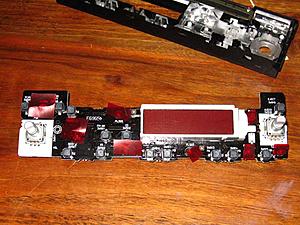

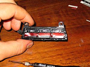

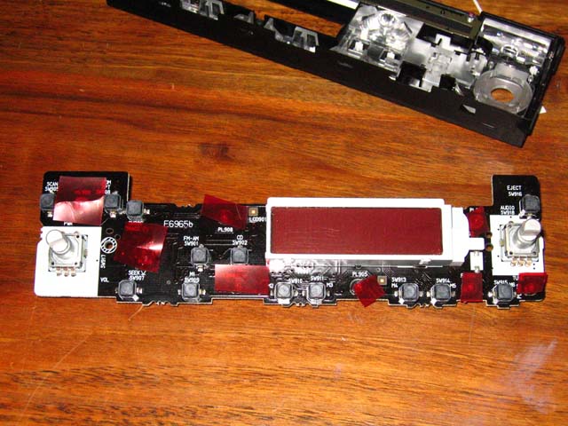

You can now choose between painting the lights or putting small squares of film on them.
Here how it should look with the squares.
Cut a rectangle of single layered film, C 145 A (lighter than the C145 B we used up to now) of 57 x 16 mm, and put it on the display.
DO NOT touch the adhesive side or you'll leave ugly fingerprints that will show on the radio display.
Position it on one end, run a fingernail in the centre for all its length, and then on the sides from the center outside so that you don't leave trapped air.

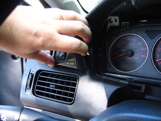

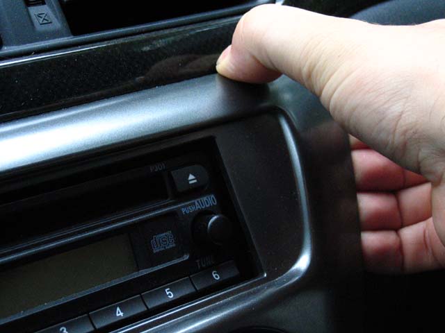

First we need to take out the instrument panel bezel. This is very simple: you just need to remove the two screws that fix it to the upper dash. It's easier if you put the steering wheel at its lowest position, and use a short phillips N° 2 scredriver.
Use your fingernail to lower the upper part of the bezel, and then pull it out an inch or so, then pull out the lower part and it will come off easily. Be careful not to tear the rubber flap covering the steering column.
Grab the left fake-carbon fiber panel and pull out, it will come off nice and easy.

Switch the two main air vents to "OFF" so that you don't damage the internal lids when you remove the panel-vents-clock assembly.
Grip the side of the long side panel on the left. Make sure you removed the two screws on its lower part.
Pull on the panel: work on it a locking plug at a time. Do not force. Always pull outside, never lift, pry or rotate. Make sure the white plastic clips are on their plugs. If one comes off, just push it on again. Make sure no plastic clip remains in its hole in the dashboard, or when you put everything back again it will be pushed inside the dashboard.
When pulling take extreme care that you don't pull on the clock and hazard button cables, especially if the plugs suddenly give and the panel comes off abruptly.
Remove the hazard and clock plugs by depressing the tabs and pulling on the plugs (NOT THE CABLE!).
