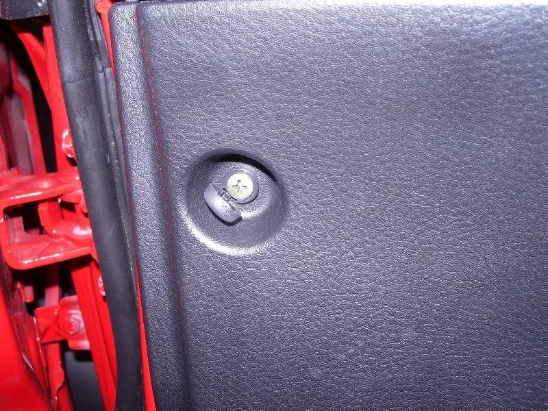

Here is one of the caps with the screws under them. Pop them open and remove it. There are 2 of these on the door.
