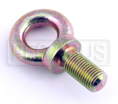

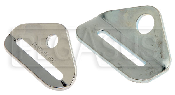

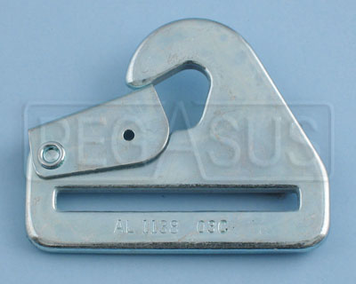

You could thread the strap w/a clip and then clip it to one of the eyebolts for the lap belts...assuming that you didn't use this kind of fastener to attach the lap belts
Use this clip
along w/this eyebolt
I've seen a lot of rally car guys do this type of install on the sub belt.In our rally car, we just weave the sub belt around the seat mount bars we've got under us. I wish we could remove those bars to get our seat lower.
