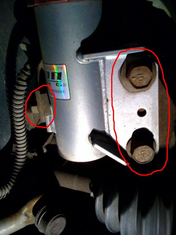

This is my first attempt at a how-to video. I hope you enjoy it.
Part 1: http://www.youtube.com/watch?v=zsXNcIAtG1k
Part 2: http://www.youtube.com/watch?v=UU764dVzcoA
UPDATE:
"Why did you have someone stand on the rotor to get the rears out?"
The opposite side is on the ground, under compression. That pressure is transferred to the other side via the swaybar. If you have a bigger swaybar, as I do, it compounds the problem. It's really not that big of a deal. If you disconnected the swaybar or used a shop lift, it probably wouldn't be an issue at all.
Since the video doesn't show the bottom front bolts, here's a picture showing the strut bolts and the brake line bracket.
