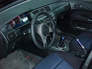

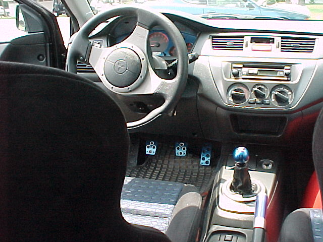

Can you post a picture of what your instrument panel looks like.
Old Nov 8, 2003 | 11:41 AM
wmcorcor's Avatar
Posts: 606
Best I have now...

One more
