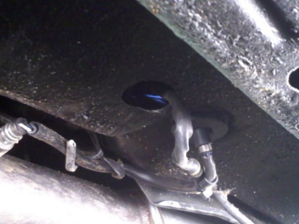

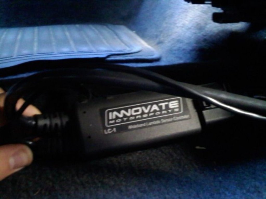

Okay.. another question.. I though that there was only one oxygen sensor back here located on the test pipe. Here what i found after i bought the nonfoulers..(sorry if they are a little blurry- its with my phone)
There is two of them. They go here..
And appear to be connected right under my passenger seat. I thought this had to do with the o2 wideband sensor but isnt it supposed to be connected up front?
Do i have to do this to both of them?

You have an Innovate LC-1 wideband O2. You should have a wideband O2 gauge with it or maybe the previous owner just use it to log A/F for tuning.
