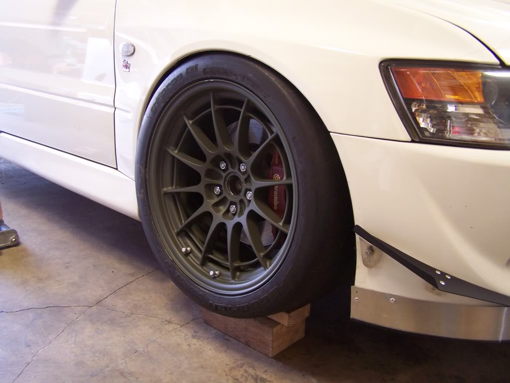

1. Figure out which areas of the fender lip needs to come off by test fitting your wide, wicked offset baller status wheels. I place a block of wood under the selected wheel so the tire will tuck into the fender.

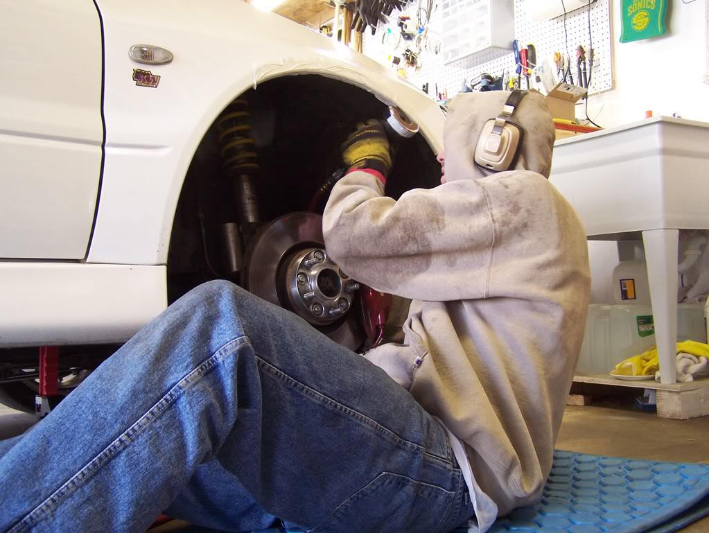

4. Use a rotary cutoff for the business. An air powered unit makes it a breeze. A Dremmel tool will do it, but it takes much longer especially on the steel double thick rear fenders.

I always wonder why the Enkei NT03 wheels have those twin air valves.
Old Oct 17, 2009 | 08:47 PM
ohhgyeahfasho's Avatar
Joined: Oct 2006
Posts: 179
From: Los Angeles, CA
"THE NTO3+M ALSO FEATURES A RACING TWIN VALVE DESIGN WHICH ALLOWS FOR ACCURATE MONITORING WHILE ADJUSTING THE PRESSURE." Straight off the Enkei website. http://www.enkei.com/RacingSeriesSpecs/NTO3+M.html
