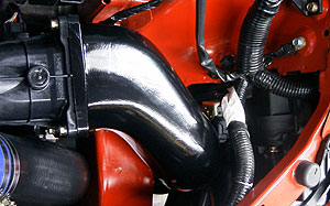

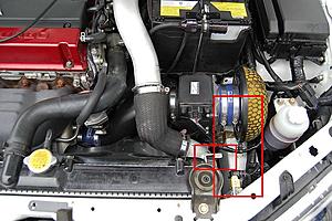

Had anyone installed the APS intake in their car ?
I gotten hold of a set, but noticed that there's this big metal beam blocking the way, see the large red rectangle.
Any advise here ? A walk thru will be perfect !
THANKS

They only work for '03-'04 evos that don't have the ACD. From the right pic, looks like that is an evo 9 that has ACD.
