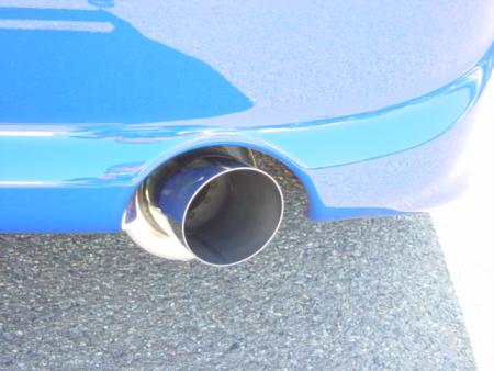

I like the angle cut (since it's a straight shot out from the cat), but as far as the rubbing goes, make sure the exhaust is mounted properly in the hangers. If so, it should have about an inch of clearance all around.

I also have the RMR and just like Chris said it should look like his pic above. Mine does

Mine does look like the picture above but the bottom left part of the muffler touches the bottom of the bumper. I am not talking about the tip but the actual muffler itself. I think it has something to do with the hangers or maybe the length of my piping.
