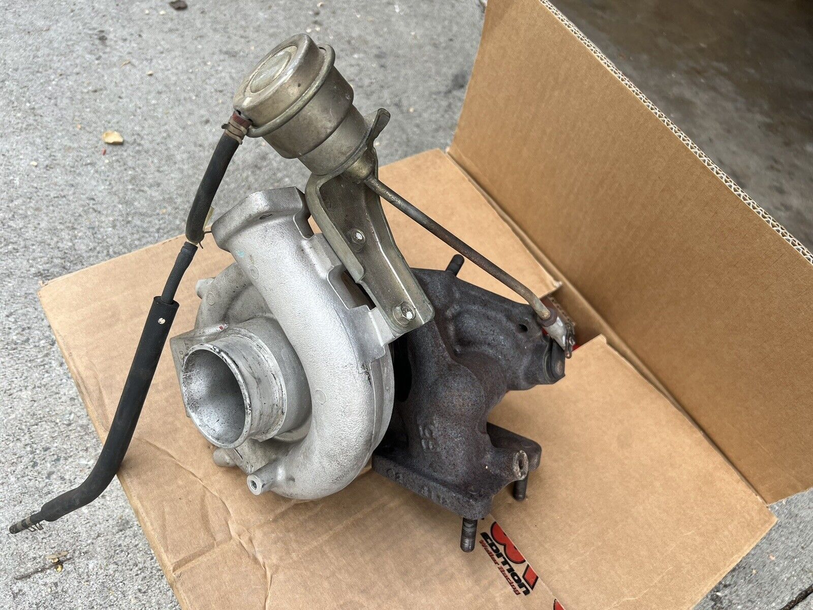

My high milage Evo (~190k) has been in storage for years and I want to get it back on the road. I wanted to start this thread to document the journey and ask the community for help.

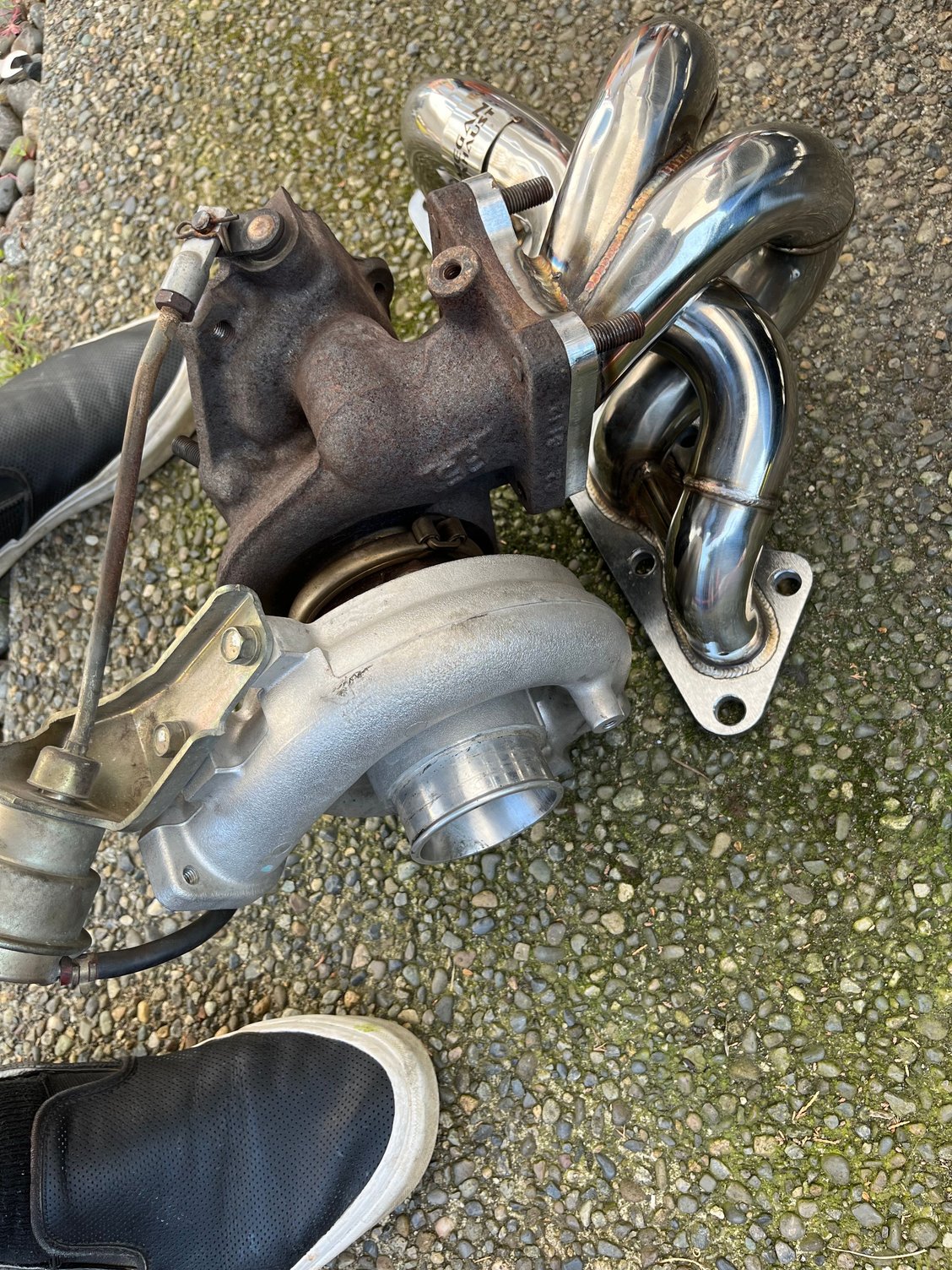

  • The stock header had a crack and I sheered the bolts going to the turbo when trying to replace it. What is the best way to proceed with the header / turbo bolts? I was planning to drop the exhaust and remove the turbo and take it to a machine shop to remove the bolts. The turbo was in good working order when the car ran. I do want to upgrade to a bigger turbo eventually, but not sure if I should do that on a high milage engine / before a rebuild.

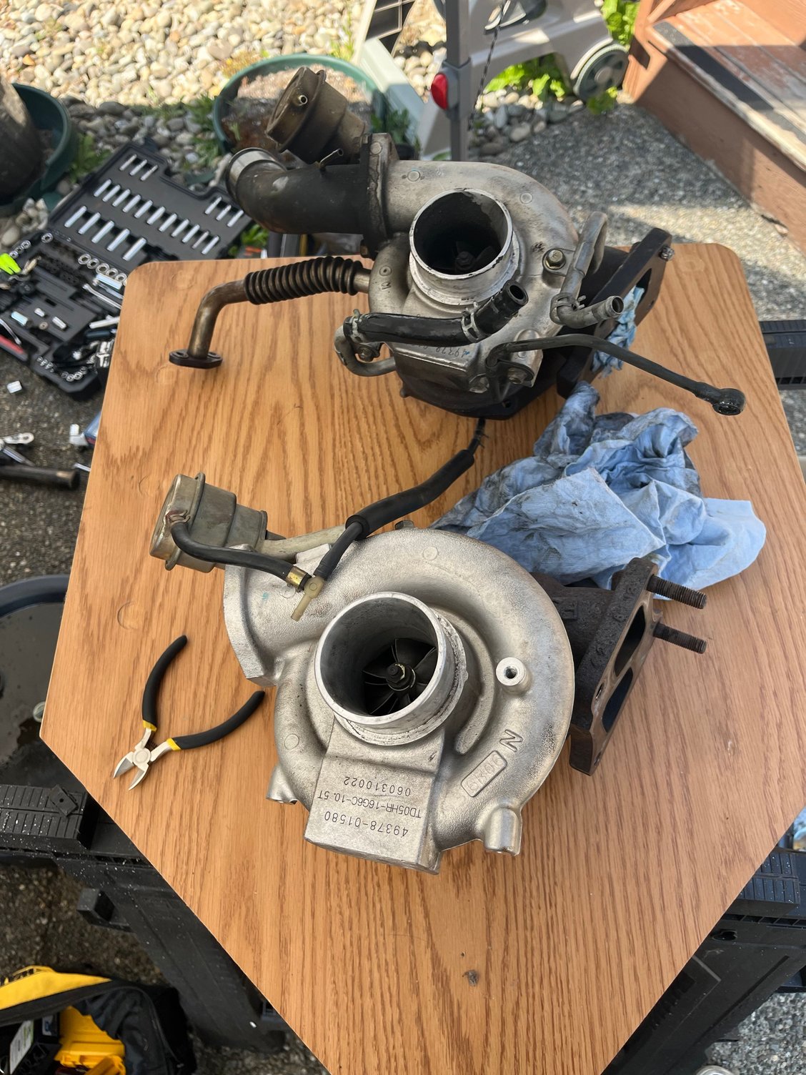

I'd just step up to an oem EVO 9 turbo right away and not put any money into the stock evo 8 turbo. (upgrade your o2 housing while your at it)

Thank you for the recommendations. I ordered a used Evo 9 turbo and install kit from MAP Performance.
I have an o2 housing with a dump pipe already installed and a new gasket. Do I need anything else for the install?

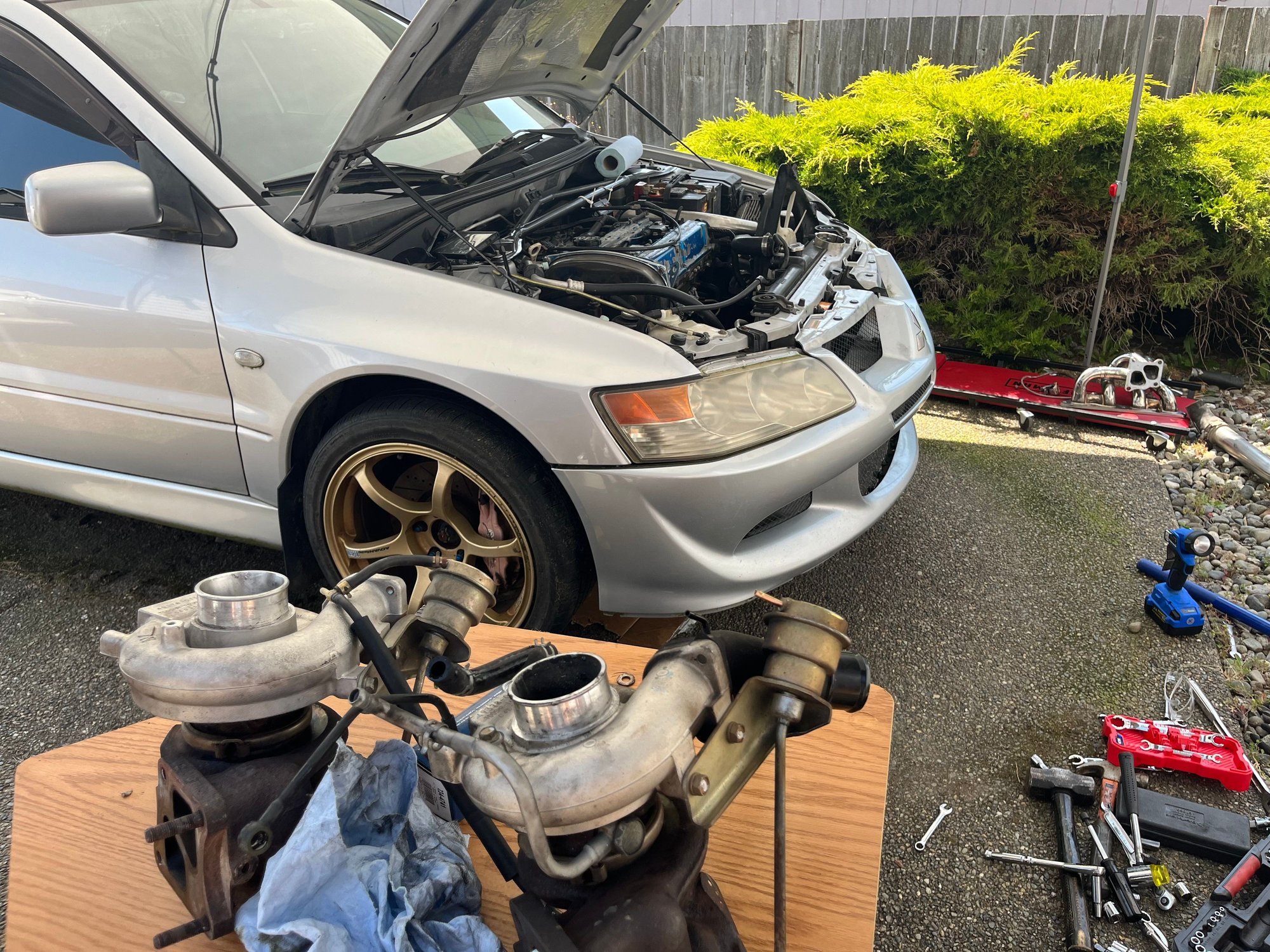

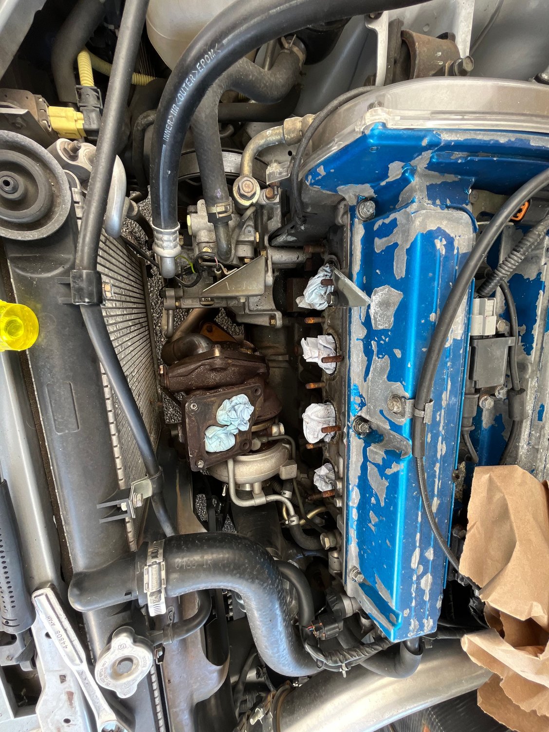

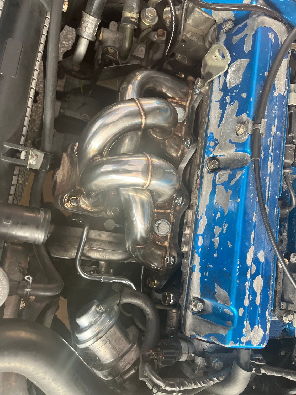

I completed the swap this week. Still need to tune it after I use up the old gas that was in the tank. I unplugged the crank angle sensor to prime the oil through the turbo and jumped it. Started right up.
