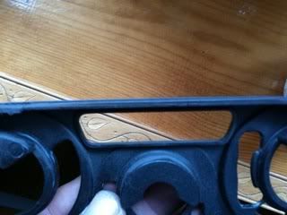

When the top is done, this lip in the middle circle on top should be pretty thin. Picture.
The bottom has a very small lip to it already which is why it didn't need cutting to begin with (which is also why a level is not required for the bottom). This can easily be done by eye unless you have crooked vision, by following the edge just like the step above, keeping it straight across. That's why this gets sanded from where it is. Here's a picture, keeping that edge straight across the way (blurry on the right). This is also where you need to STOP sanding for the bottom. Once you have that amount of edge on the bottom, you will want to turn it over and look at the front. The bottom picture is about where you should be at.
You DO NOT want to go too much into the bottom, since that is what's most visible by the driver/passengers in the vehicle. You want it to stay as clean as possible on the bottom, while still achieving enough space at the top. You DO NOT want to cut into the circle where the decal is placed, to achieve that clean look. In other words, the bottom of the decal should require NO TRIMMING at all. You CAN cut into the lip heading into the circle, but not into the circle itself. Picture below (paper stuck on the bottom from wiping clean lol).
This is what your bezel should look like now.
