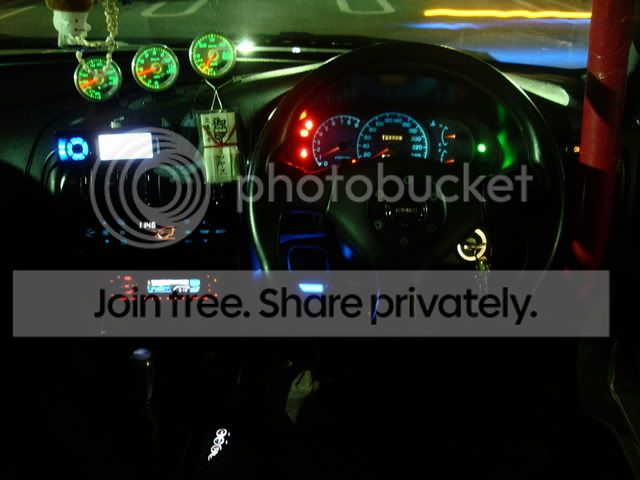

This is the final product in my car. I did the red gauge needles with a red sharpie while I had the gauges out and opened. Also I did the AC panel with the same transparent folder, really just took it apart and put 2 pieces of the transparent folder in the back of the buttons. So in all this mod cost about $4.00 and took about 1 hour, very cheap and easy.
