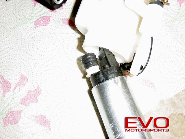

Installed a Walbro fuel pump a few weeks ago, one thing that did bother me was that white washer(looks like a top hat) that fitted just below the rubber washer that pushes up into the housing was real loose and didnt really seem like it did anything? It was not even helping push up against the black rubber. Anybody else think that was strange?

pic of the washer

Did you reuse the OE pieces to put it back on? I've heard the Walbro ones don't fit perfectly in there.

ak47pro,
on pic 13 of that it shows the white spacer, i did it just like that but the left to right movement of the spacer is what im taking about not a good fit at all.

I had a customer car recently that seemed to be down on fuel pressure, after some convincing I finally got him to pull the pump and inspect the install, sure enough it was missing the white piece. He re-installed it with that piece and fuel pressure is way up.

well lets hope mine is ok. when i first did it by accident i pulled out the pressure swich and pushed it back pressure swich into its sleave but the o-ring went in sideways! so put it all back and had pretty much no pressure , could not start the car. then after pulling it all out 4 times and even putting the old stock pump back we found the problem.
that washer always bothered me because of its fit thou the fact that it helped push up against the black rubber is good but its not made to fit .
I can hear a very slight drone (fuel pump motor noise) coming from the pump, have to put my head on back seat to hear it sometimes and sometimes can just hear its faint pitch of a noise... hope thats normal

mine fit pretty good when I did mine, if I remember right

installed mine the other day , it was a bit snug but it went together ok
