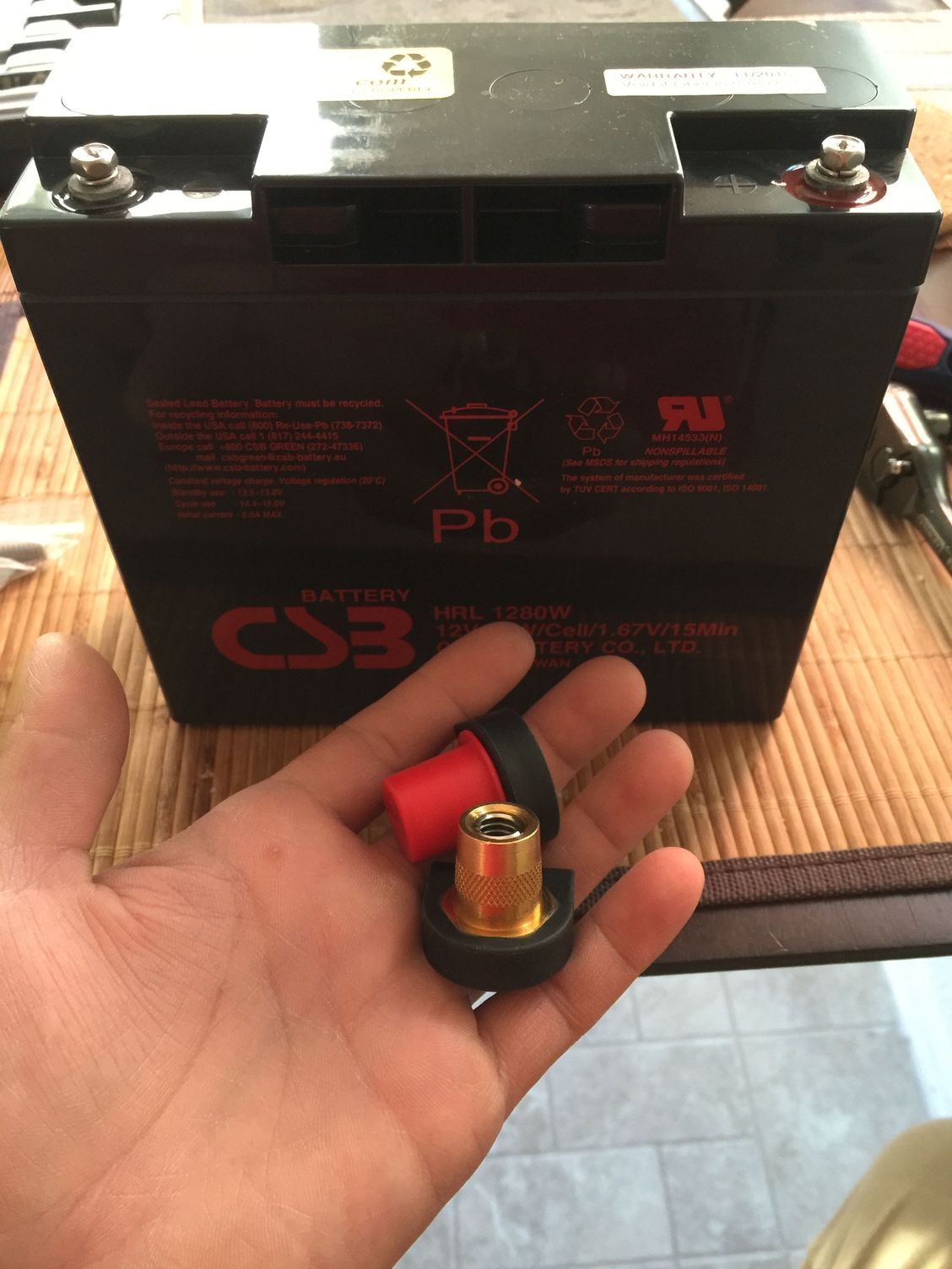

sorry to bring this back from the dead, but i purchased the battery on amazon and ordered the odyssey terminals as well but the terminals don't seem to fit. anyone buy the same battery? if so where could i get terminals?
I bought the XS power terminals that fit with the amazon battery. I believe the part number is 586 (got it on eBay for under $10 shipped). You will need to get M5 bolts though, as the ones provided are M6.

For the terminals the XS power terminals (586) fit perfectly.
Amazon Amazon
Just keep in mind you will need to swap out the M6 bolts with M5.
