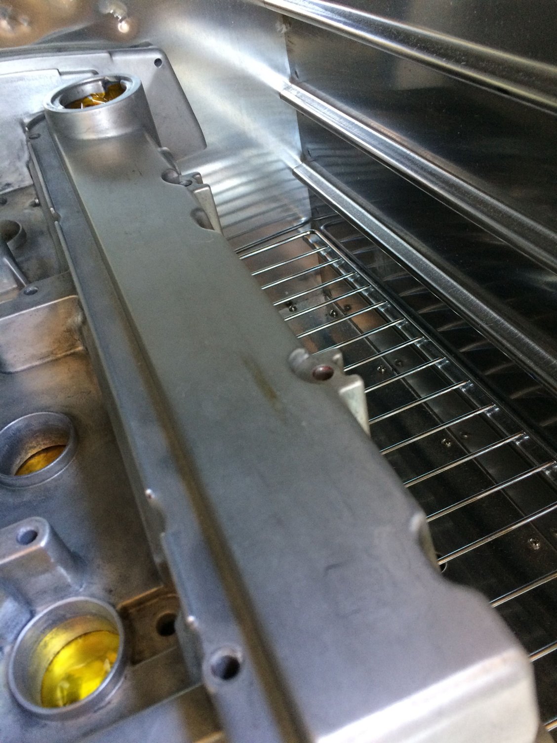

So first step after everything was degreased was to prebake the valve cover in the oven, I did two cycles of 30 min each once the part reached 420 degrees Fahrenheit. And it’s a good thing I did because it seeped oil out of one of the pores and if I shut powder and baked it that would have a problem, check the picture.

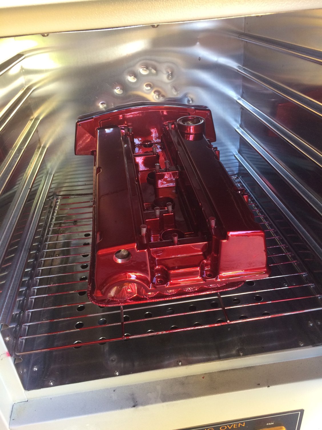

This is what the second coat looks like before curing. And even tho I preheated the valve cover to 350 magnesium cools off so fast that the powder didn’t melt. Cure schedule for lollipop red is 400*F for 10 min, again start timing once the part reaches 400.

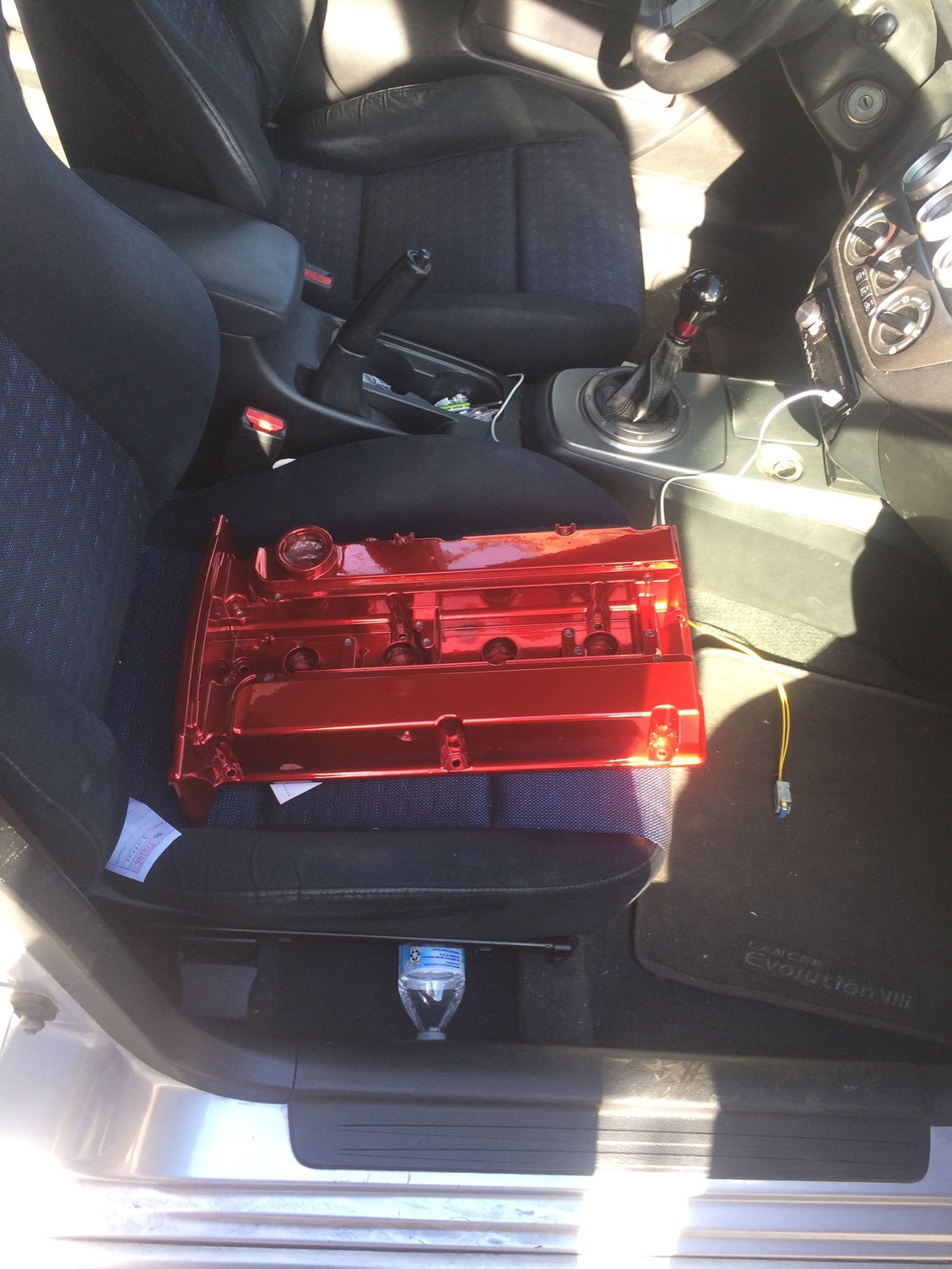

And this is what it looks like after it’s cured.

So I followed the cure schedule the T, I extensively degreased the valve cover before prebaking, however for some reason on the front face of the valve cover there are tiny little bubbles, they aren’t too noticeable but still pissed me off. Also I had two inline water separator filters so it couldn’t be moisture. Will post pics later.

Wow looks great. Looks like a new oem piece but with more shine

Looks good dude. I've dealt with bubbles plenty. You were thorough with the prep and the air supply had a filter which is where they come from 95% of the time or if there was a heat spread issue in between coats but other than that sometimes it's because of old powder

Thanks man, yeah I don’t know what else could have caused it, you saying that makes me feel better lol.
