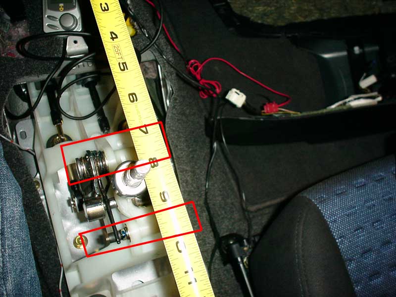

Ok, now to the shifter itself. I really had some pics that I now can not find. So I'm using what pics I can to show the process. You have to remove the rear housing bolt and front housing bolt highlighted in red boxes in this pic. The front bolt holds the centering spring along with a lot of washers. When undoing these take note of the order the washers are in. Everything must go back the same way it was on before. You'll need an 8mm allen wrench and a 12mm socket to remove the front bolt. I actually did not pull it all the way out so all of the washers and springs on the left side of the front bolt including the spring were left in place. That leaves only 2 washers on the nut side to remove. The rear bolt requires an open 10mm wrench and a 10mm socket. This however I removed the entire thing.

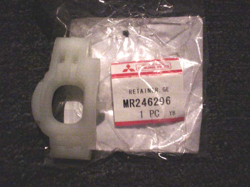

This is where I got screwed. So for anyone doing this please note not all shifter assemblies will be the same! Once the 2 bolts are removed or in the case of the front one I slid it out just enough to pull the "gearshift lever retainer" up and off the shifter. ONLY mine won't come off! Yes they are supposed to. I guess they decided after putting the thing on they'd weld a round cylinder to hold the shift boot but forgot to file the edges! SO, luckily the piece is a part you can order. I did just that and as you can see in the pic there's the part # if you need it. The piece will run you $20 after tax.
