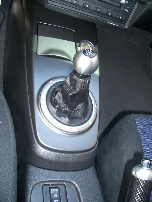

Just for kicks, I also opted for Mitsu's cool brushed aluminum shift knob. Here's a pic of the result...

redevo8driver's Avatar
Posts: 274
From: Enfield CT
is that the shift knob that came with it? i really like that..i was thinking about getting the kit for xmas or selling my bov and then using money to get it..
Old Sep 18, 2004 | 12:03 PM
Ted B's Avatar
Posts: 6,334
Likes: 63
From: Birmingham, AL
No, the shift knob is an item that can be obtained through a mitsubishi dealer. I don't know the part number, but you can find it conveniently online here:
http://www.mitsubishiparts.com/defau...acturers_id=18
