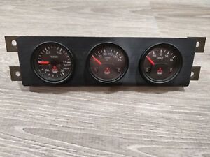

Hey guys, so I’m all about the OEM look and would like to get this OEM gauge cluster I’ve provided picture of, installed in my 2003 Evo GSR. If anyone can tell me do I need a relocation kit of some sort or will those gauges just fit flush right at the area I circled at ? which is where I would like to have them placed. Thanks

You need this.
https://stmtuned.com/collections/evo...it-oem-evo-8-9
This is the how to thread for relocating the gauges to your current radio location. Which is not what you want but, may give you some insights on how to do it.
https://www.evolutionm.net/forums/ev...-relocate.html

Yeah I actually don’t want the gauges where the radio is at the top and the radio put towards the bottom. Before the person in the pictures starts he provided a picture if exactly how I want mine to look. So if you could tell me if I already have the gauges how to I get them to fit properly down there like that down there , thanks.

If your car didn't come with the gauges stock you will need the squared off lower bezel Wheelie linked you to. Took me like an hour when I did it, easy enough.
