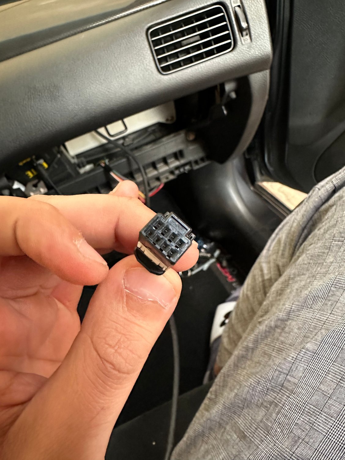

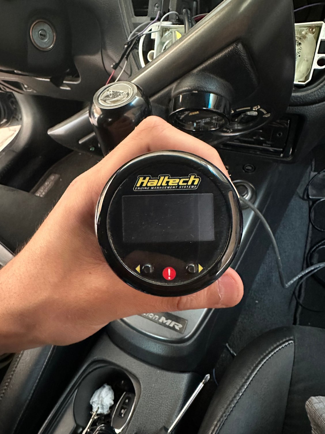

I bought a used car and its equipped with Haltech ELITE 2000. Also, its equipped with a HT-061010 Multi-Function CAN Gauge but it not connected to the Haltech ELITE because the cable connection of the CAN Gauge is different than the one goes to the Haltech ELITE. Where I can find a conversion adapter (Male 8 pins to Female Haltech elite 4 pins). Or where I
Haltech CAN Gauge
Current cable
Have 8 pins
Haltech ECU port is 4 pins
can I buy the CAN Gauge cable separately.
Attached is pictures to explain the issue.

I don't think Haltech makes an adapter. Looks like your need a new more recent gauge.

de-pin the tyco-8 connector, and pin it into a DTM-4, super easy

but how can I know which wire goes to which connector as one side is 8 pins and the other is 4 pins. If you can guide me I would appreciate it.

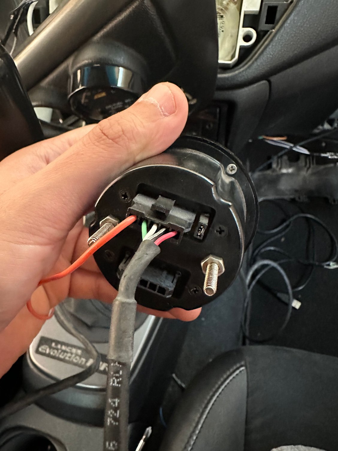

is there 8 wires going into that connector or just 4?
Old Mar 27, 2023 | 05:02 PM
HKGREEN's Avatar
Joined: Mar 2023
Posts: 5
From: Kuwait
they are 6 wires. I will get a clear picture tomorrow a share it with you guys.

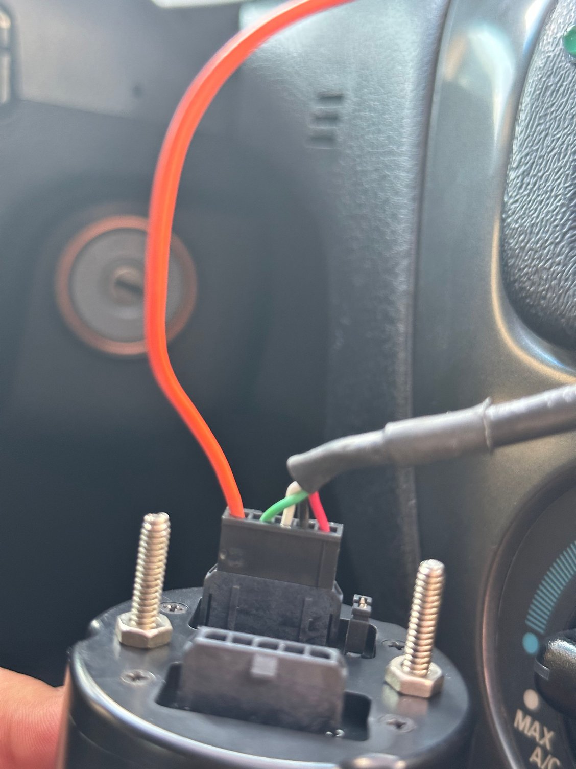

actually they are 4 wire.
Behind the guage
8 pins connection
Colors are:
Black
White
Green
Red
Old Mar 28, 2023 | 01:46 PM
HKGREEN's Avatar
Joined: Mar 2023
Posts: 5
From: Kuwait
Got it done
Pictures below
