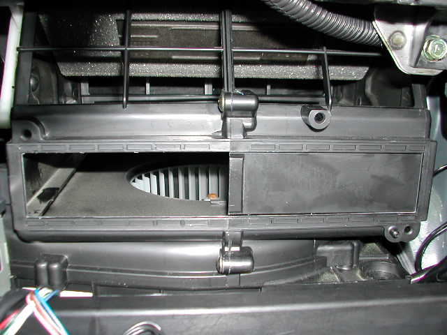

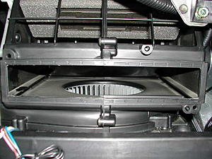

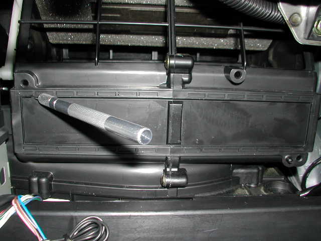

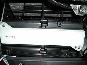

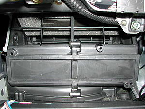

-Remove the glove box and locate the blower box. '03 models were not equipped with cabin air filters and there is a panel that can be cut inorder to fit a cabin filter. If your car already has filter in place you can simply replace it if neccessary.
-Simply follow the groove of the panel to be removed for the filter with a X-Acto blade.
-Remove the panel.
-Clean any dirt or dust in the blower housing and insert the cabin air filter.
-Secure the cabin filter with 2 tapping screws.

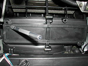

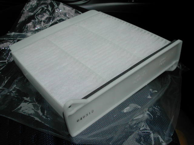

Here's the filter itself.
