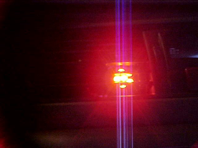

Below are some pics of my finished product. You can sort of see the light hiding behind the vent when it's off. When it turns on it's VERY bright, seeing it in daylight is not an issue. My camera sucks, but you can see that even when the flash went off the light was still bright.
