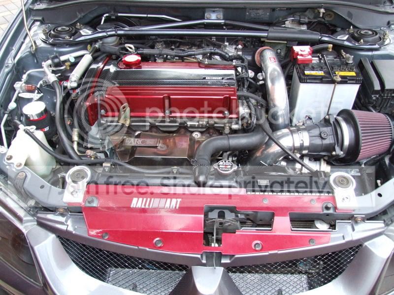

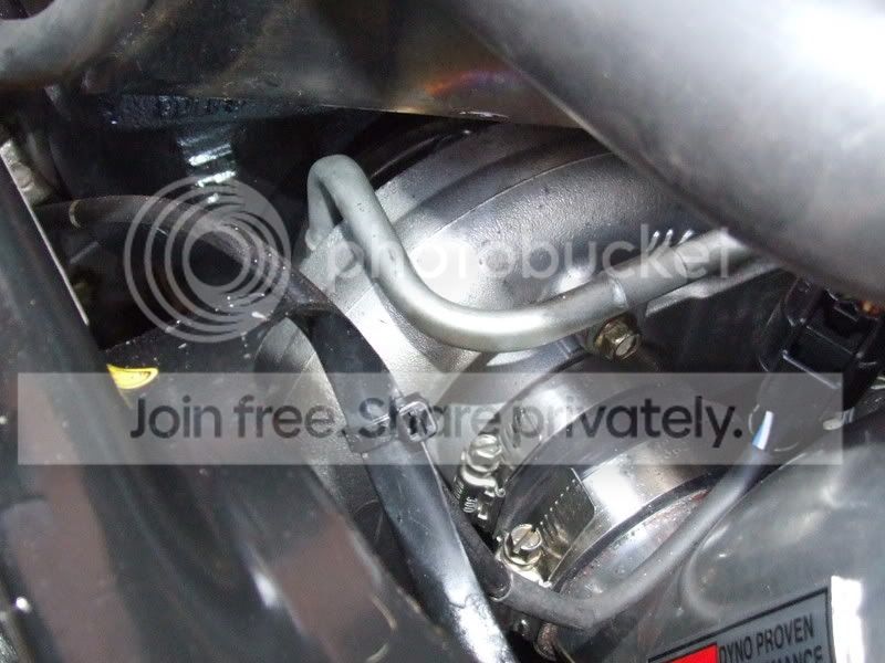

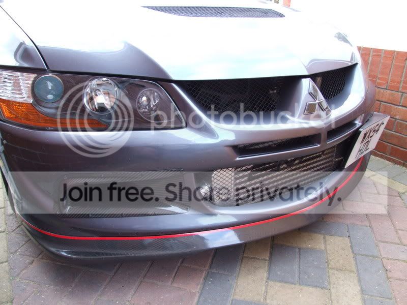

well folks the turbo and new exhaust are now fitted
got it fitted yesterday and boy it sounds wicked, spools very fast which is good had the car in at mitsi today for a 4.5k service and all reports are good with no problems...
i got to my mates garage yesterday morning and got cracking straight away, turbo was soon off after some thinking quick removal of the fan and the turbo was soon out and the new 1 in place,
next set about fitting the new exhaust and got the front pipe on,decat, and the new greddy ti-c got the cooler pipes back on to the turbo, checked everything over underneath and got to work up the top..
got the air filter and inlet pipe back on, last thing to do was fit the lambda grr with the new turbo elbow the lambda wires was to short. so i set about unpicking the wiring loom and removed the lambda wires from its orignal location and the lamdba now runs to the right hand side of the engine, a hour wasted but a solution it was..
checked over everything and turned the key sounded mint only 1 thing left to do was remove the exhaust bung. now it had a bit of bark back :wink:
its great when ya turn the engine off and the turbo is still spinning :crackup:
some piccys

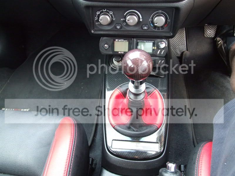

sweet ride!
nice looking interior too
I'm jealous of your climate controls... USDM evo climate controls look like they were designed by fisher price lol
