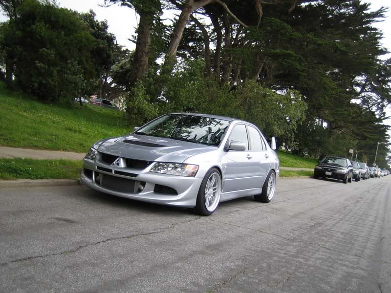

One of my fav setups:

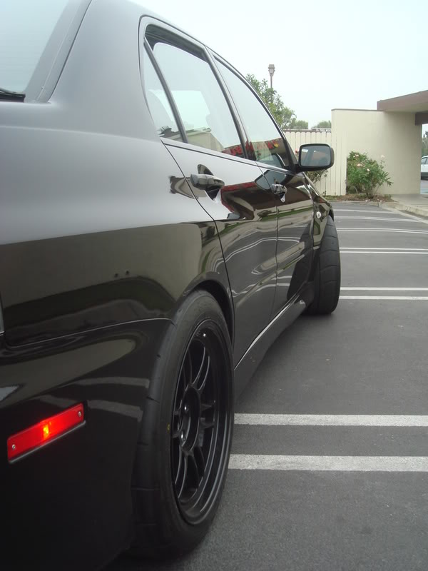

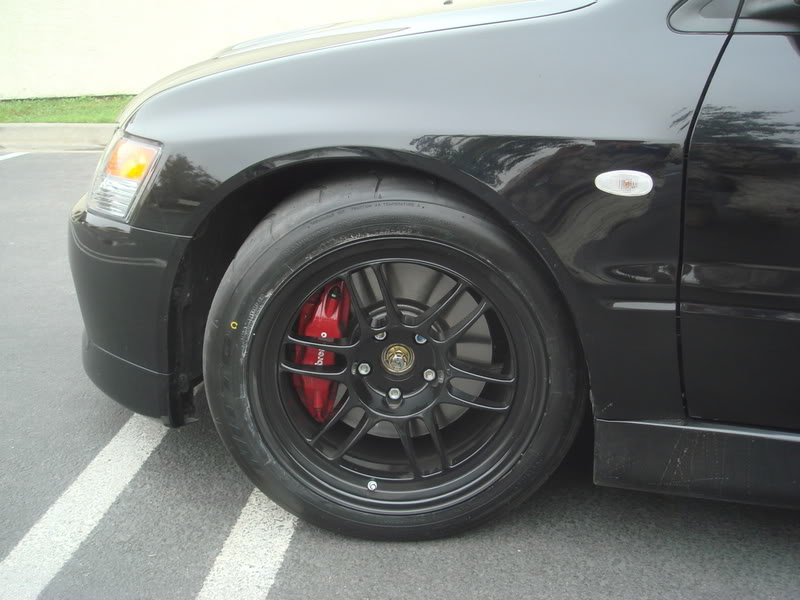

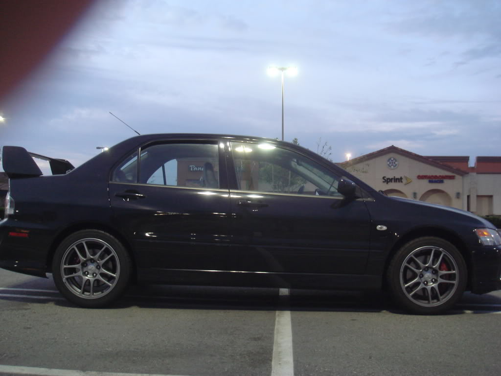

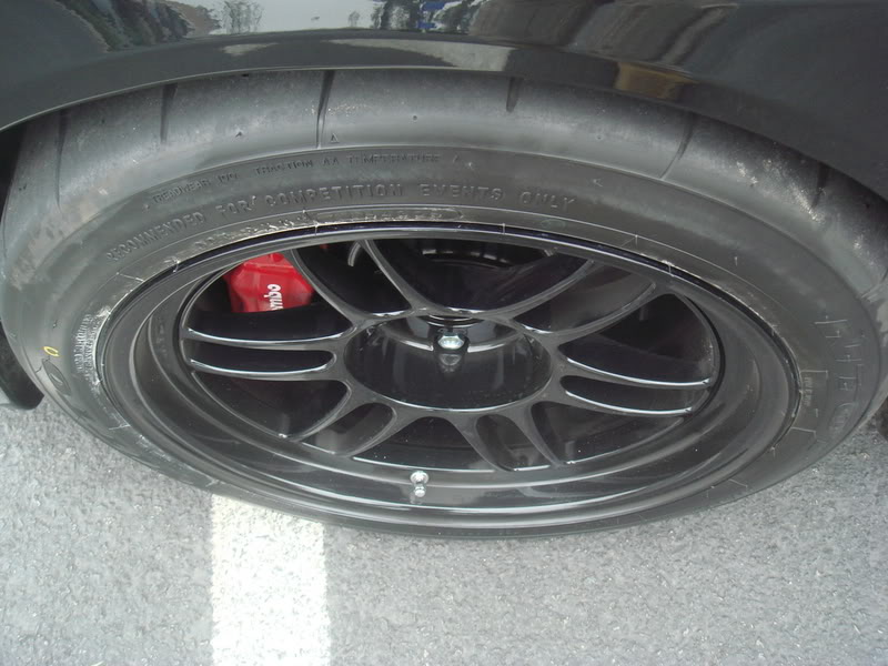

For the ones that asked these are 17x10 +18 F and +38 rears with pulled shaved front fenders and same in the back. Wrapped with Nitto NTO1's
