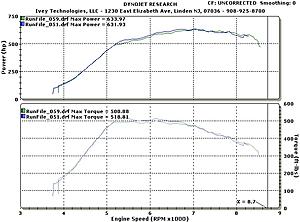

533whp on pump gas 25 psi and 630whp on 30.5 psi on race fuel, not bad for a turbo thats smaller than a 35R
CBRD TAK33R FTW
cb

Dyno sheets from the car at 29-30psi on c16 fuel, conservative for road racing.
HKS FCON VPRO 3.24, HKS AFK. Iveytune "spl" Data ;-)
Sean
Sean
thanks for posting sean,
im sure it will be back when we put the billet compressor on it, and make a cam change!
cheers
cb
CBRD TAK33R FTW
cb
CBRD TAK33R FTW
cb
The TAK33R is one of the most amazing turbo's I've had the pleasure to own. The power delivery is awesome.
Sean
Thanks for the awesome tune Sean I'll let you know how it goes once I get a dry run in. I couldn't get my foot into it at Road Atlanta in the rain. I would go 1/2 throttle from 4th-5th and the tires were breaking loose and starting to skate down the back straight. Rain sucks
