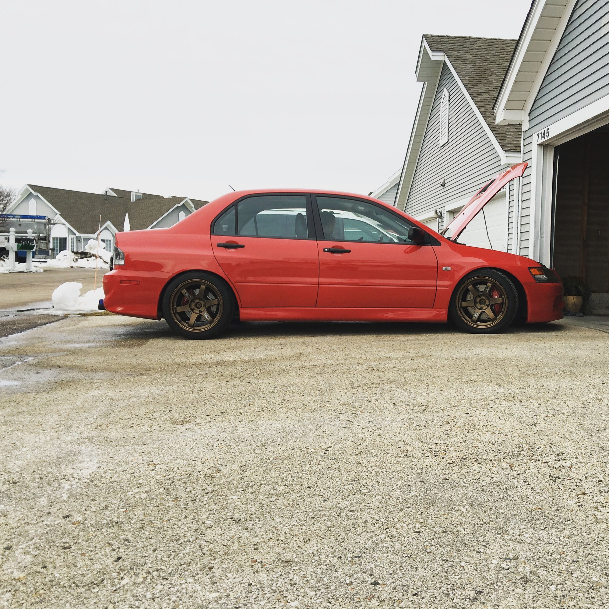

Here are mine: 245/40/17 wrapped around a 17x9 +15. Could/will go 255. I'm at -1.9 in the rear and -2.6 in the front and I fit with fenders rolled flat. Going to have to re locate the bumper tab for 255s though!
