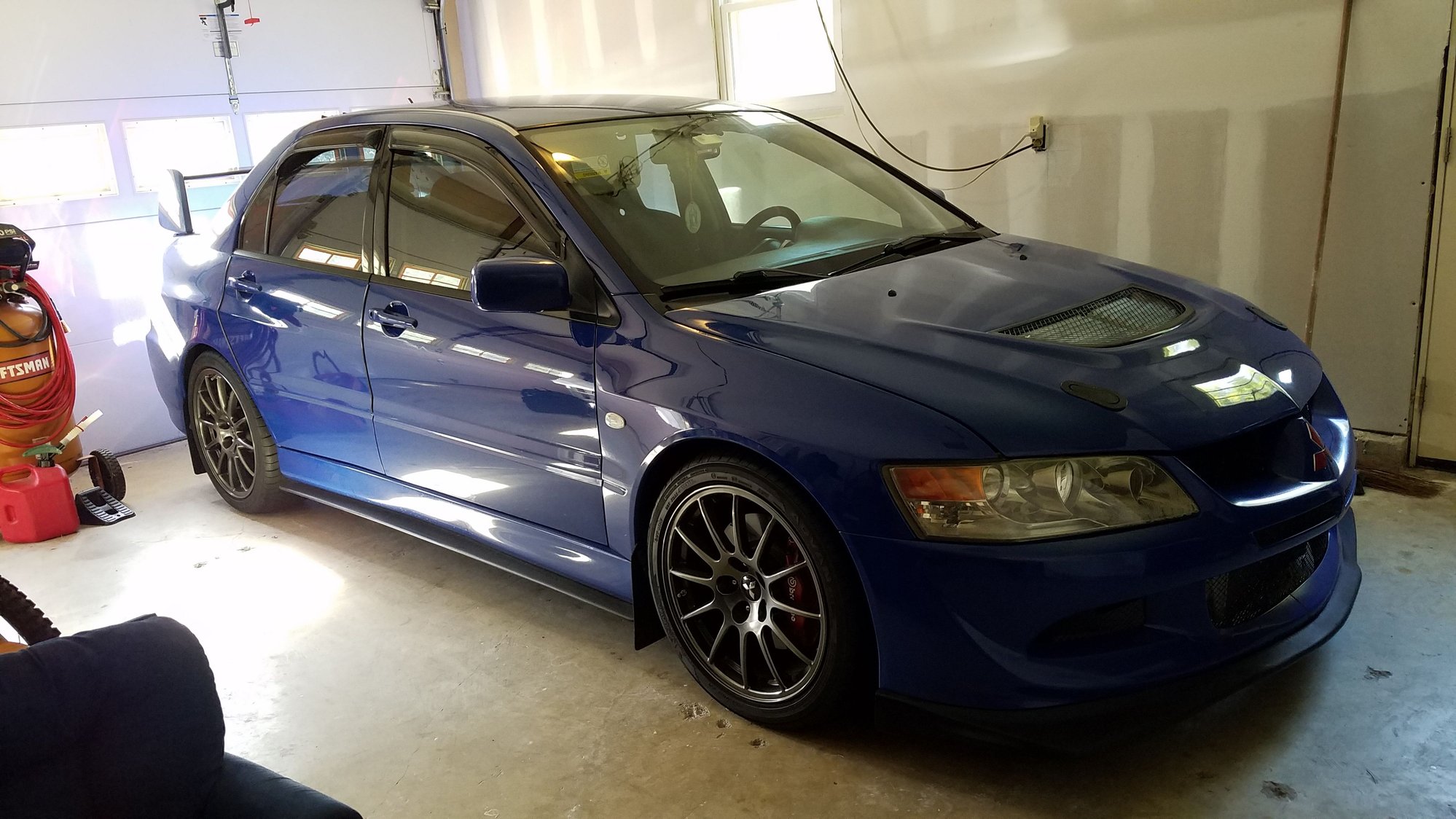

My EVO 8 blue bayou FE wheels

^-- That looks really really good.
