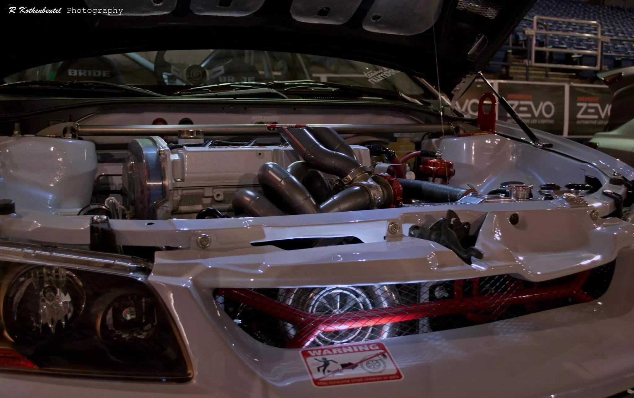

JDL auto designs t4 twinscroll super99 forward facing kit...
903.75whp/701.49 wtq
Shaved bay/wire tuck etc etc..Official (or not)  Forward Facing turbo kit thread-image.jpeg
Shaved bay/wire tuck etc etc..Attachment 245666
Very nice! What hg are you running? O ringed?

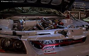

Here's another pic...
I don't have great ones on my iPad but my IG has some good stuff and Facebook page.
I'm running a cometic HG and the head is o ringed with ultimate duty map studs. No issues, 48 psi. That was stock valves, I have all oversized valves now so needs to be retuned again and with the aem 12 tooth crank trigger and fmic spray so fingers crossed for 1000whp. Bottle was empty on the 903 run.
{thumb}Arguably best engine bay to date. Good job man
