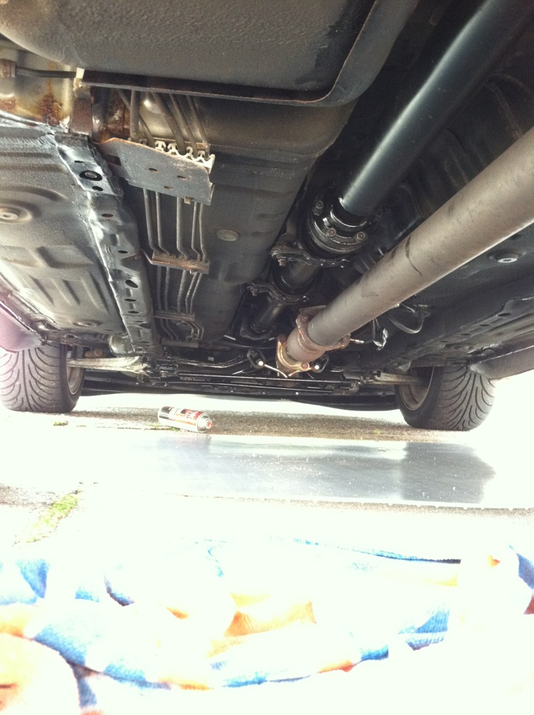

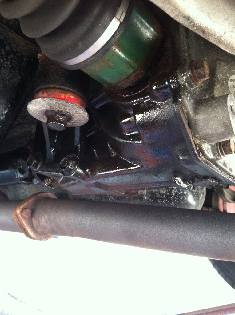

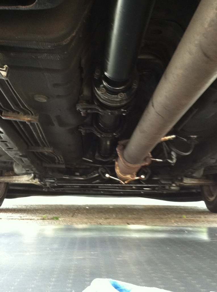

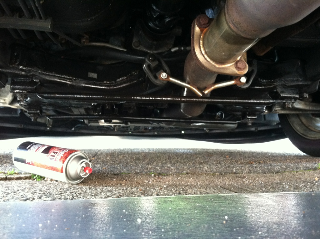

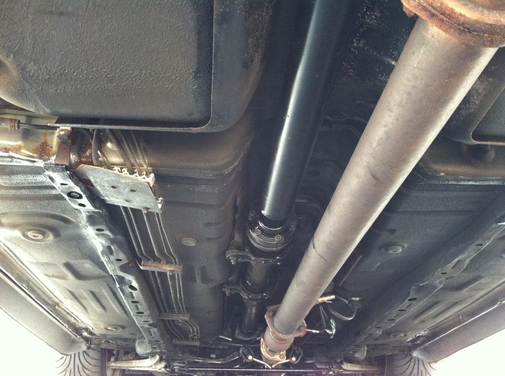

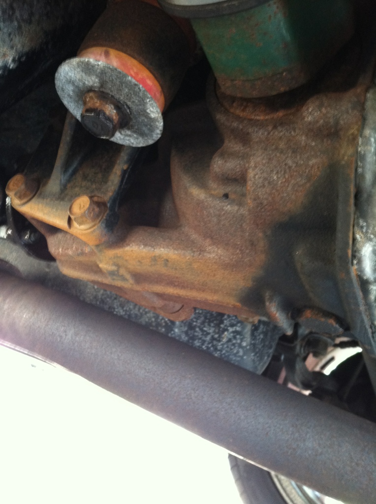

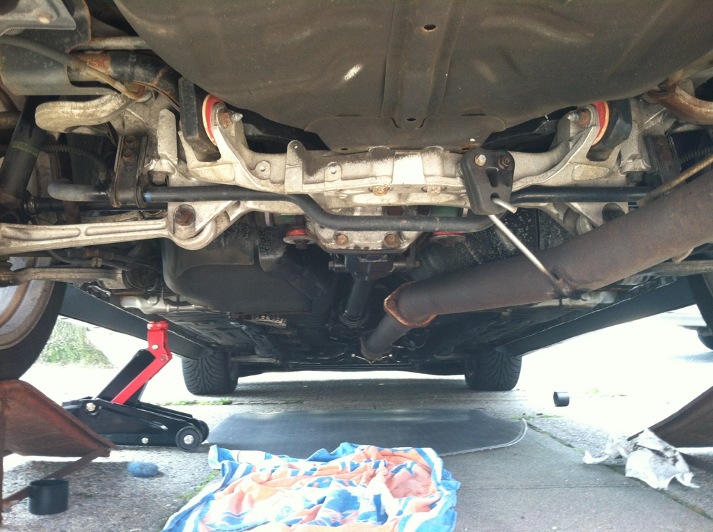

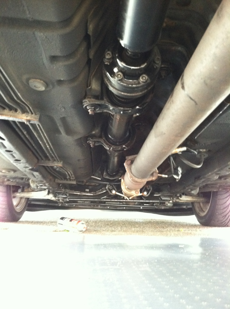

this morning i experimented and went to a parts store and the guy recomended duplicolor rust fix for the underbody, you apply straight to the rust and it turns it to black primer withing a couple coats. if the rust is flaking you can wire brush it down to the surface here are some results i think it looks pretty damn good for the price check my driveshaft in the original pics on the first post and compare them to these not bad...dont know if i should do a top coat at this point it looks decent and i dont really think i need it i mainly did it for protection. i need to finish the second half of the driveshaft still..
before rear
after rear
the rest are all after pics compare to originals driveshaft looks cleaner and has a more polished look

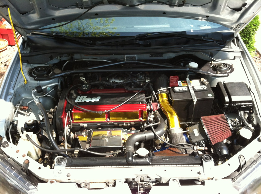

This is my bay 71,xxx miles and i dont think my underbodies that bad i think it can be better though

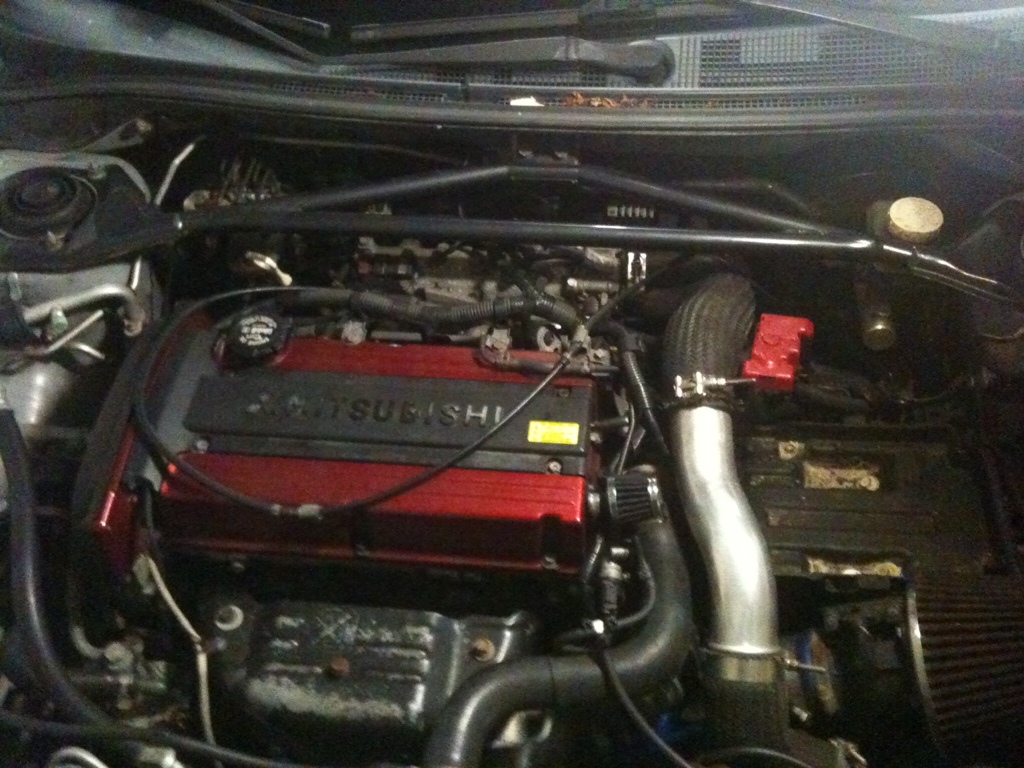

This is before i cleaned it
