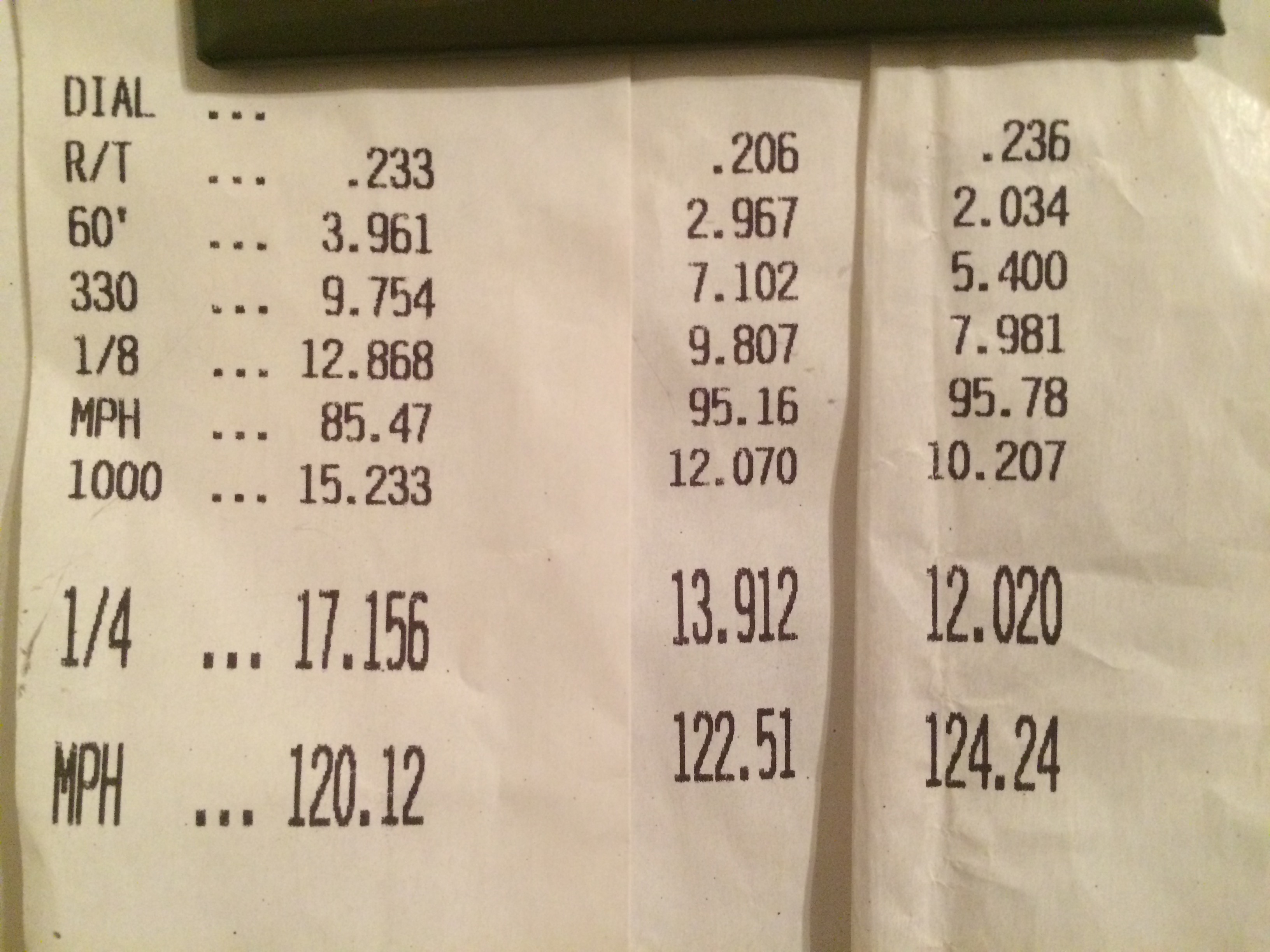

Late update. Made it to the track twice in May. Did a best of 12.1@123mph at 30psi. The Tephra launch map had me leaving the line at 1.5psi making some 1.9 sec 60' times plus had lots of misfiring from a rich tune. It was a last minute trip so had a baseline to start with. Setting the launch map to -4 degrees did a lot better on the 2nd trip making 14psi getting the times on the pic with 31psi max and still very rich tune, both left lane. I was gaining serious MPH on the back half with nothing special on the first half. Had a bog off the line on the 11.76 pass.
A few months later, I found a huge boost leak on top of a few minor ones in the form of a M8 bolt on the comp housing that I had removed to test fit the turbo on the PeakBoost top mount kit, had been running like that since January. I have a feeling this caused the poor 1/8th mile performance as the car goes hard in 4th gear. Hoping to at least get in the deep 11s at 130+mph pretty easily this month after pulling a point of fuel out and adding 2psi and go 10s before making any part changes to the car.
