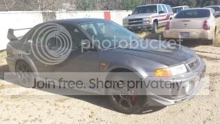

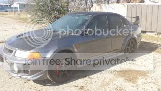

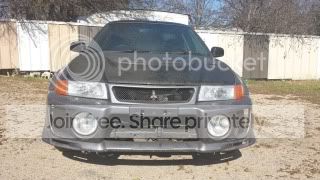

negotiated a price we were both happy with and she is now on her way as we speak....

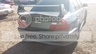

Thats why the title is built and bought. The Awd floor pan is installed, its already wired for a evo 4-8 4g63, rhd conversion is done, rear end xomponents and full suspension is done, brembos are on, even has a evo 8 ecu with an agressive stock evo 9 turbo on evo 8 motor map on it ready to fire up. All body pieces are OEM Evo 5.
What it does need is the full 4g63t swap, some interior work, fuel system redid (previous owner had fuel cell), and a bit of body work and paint.

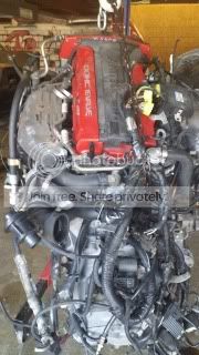

Plan on grabbing an evo 7 swap next week. Evo 9 turbo is also in the mail. Car comes with evo 8 rear seats but had stock mirage front seats. I came across a set of evo 8 fronts for a good price. Best thing about the seats is they were located 30 min where the actual car was. So guy selling the seats dropped seats off to previous owner of car and he temporarily bolted them in for me so I dont have to pay for shipping!

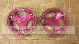

HKS cam gears...

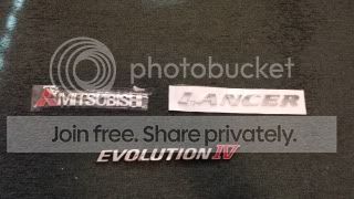

Rear emblems..

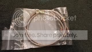

one piece SS clutch line..

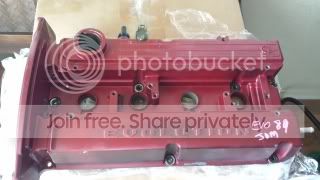

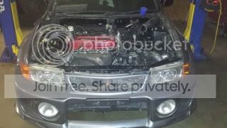

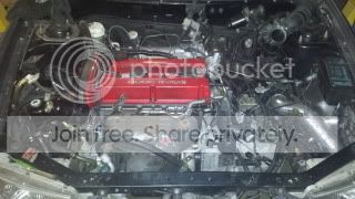

Noticed I didnt even post a pic with the motor in...
just sitting in there, not wired up. Just mocked it in there to make sure everything lined up good. Pulling the motor back out to get the bay painted. Also gonna pull off the head and take it to the machine shop to get a valve job, new valve guides and seals installed, GSC dual valve springs and retainers (just ordered today), and GSC cams installed.

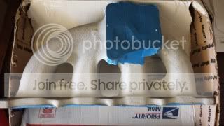

Also picked up this nicely ported and swaintech coated Evo 8 turbo manifold off a guy on evom....

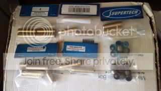

Mods for the head are almost complete. Just waiting on my beehive springs and titanium retainers, then its off to the machine shop to install everything and valve job. Got my supertech valve guides and seals along with my turbo manifold in the mail today.

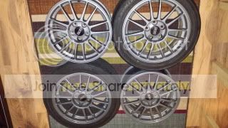

Was gonna go ahead and order my complete fuel setup, when I came across these...
Evo 8/9 MR BBS wheels in really good shape. Some minor rash on them, but thats to be expected. Going to get them powdercoated Volk Mag blue.
