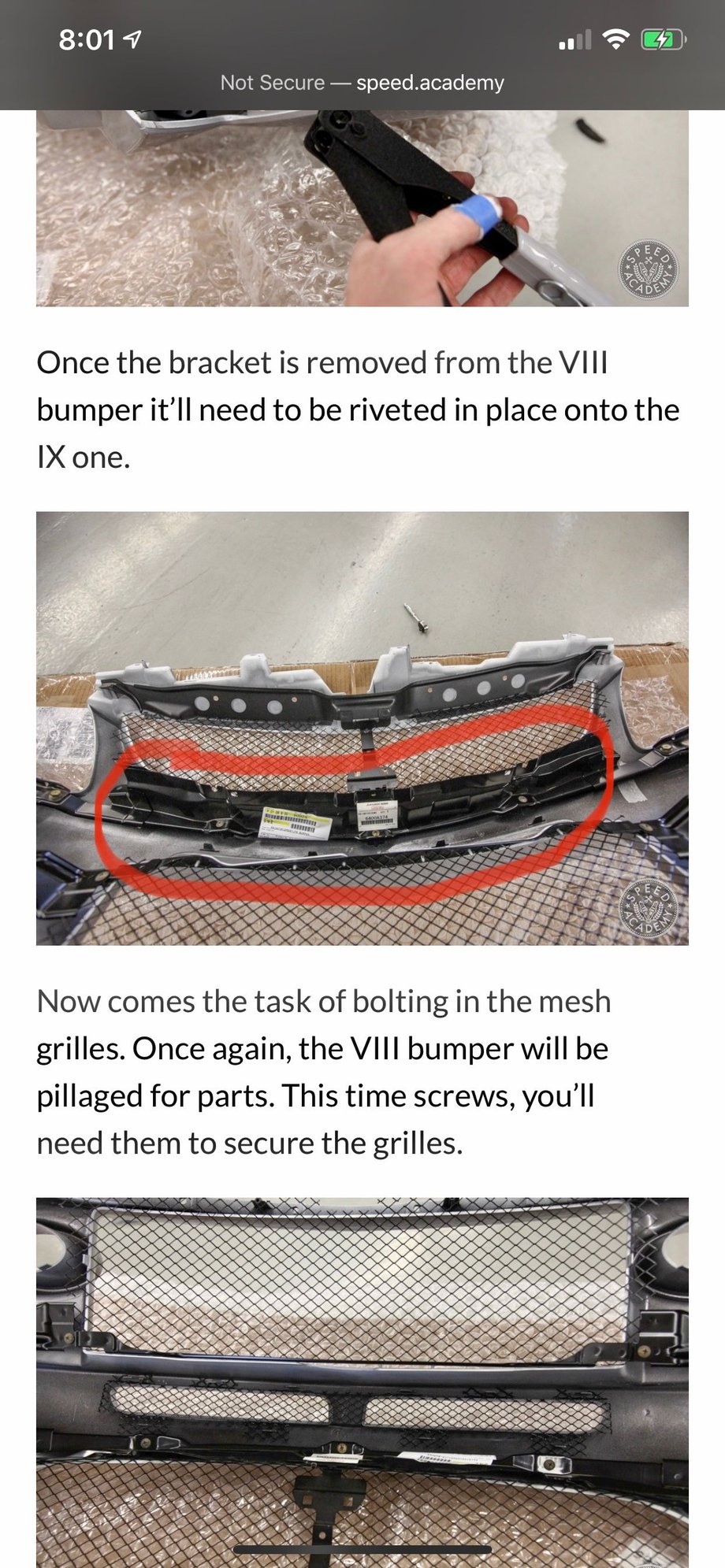

I bought the Evo 9 bumper recently too bad I listened to the demented circus monkeys that put up
half *** info on this forum, because one of the main parts to do the Evo 9 bumper conversion on Evo 8 is discontinued.
part #6400A370 The upper bumper reinforcement bracket that goes between the left and right bumper brackets and it sits below the upper grille.
