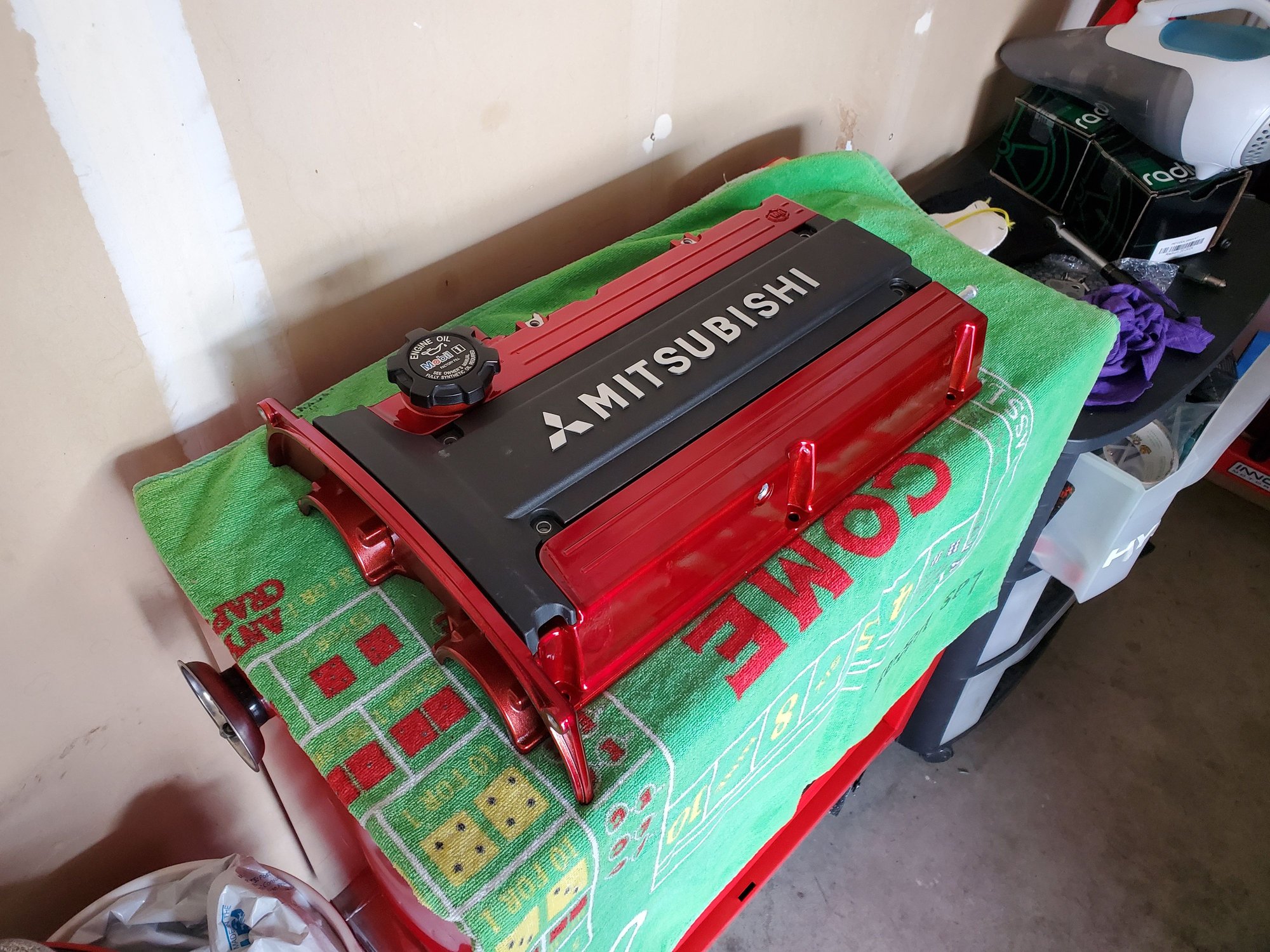

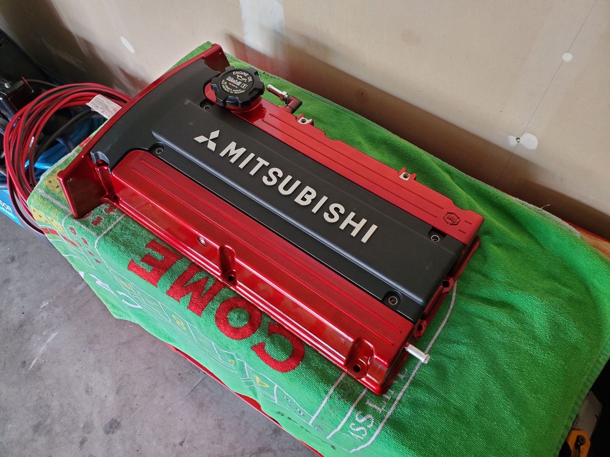

My original valve cover was looking a little shabby after 120k. I had been considering sending it out for powdercoat to Detective or someone else who'd be careful not to blast it full of media. But ultimately, I didn't need it to be perfect and I figured I could tackle the job at home. I finally found a color that looked pretty close to stock so here's how it went. The paint was about $10/can and the stripper was $17.

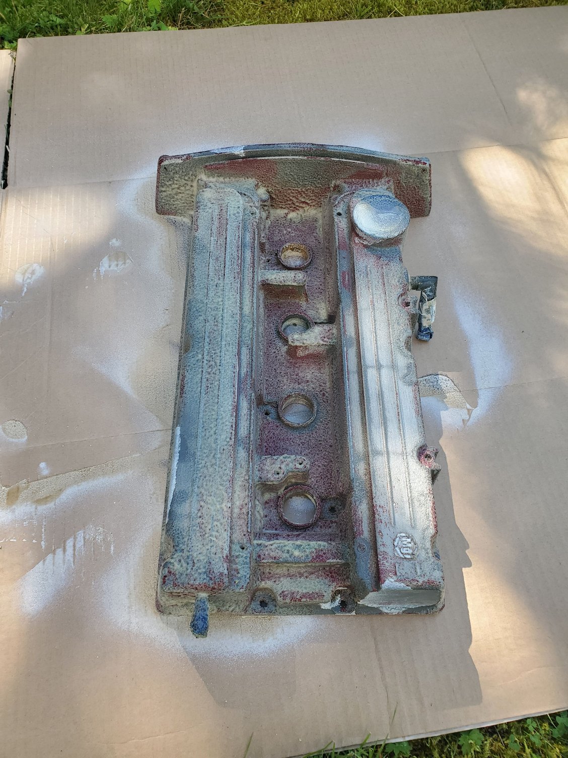

The stripper did not meet expectations. I did 3 separate soaks, 45 min each, and still couldn't get the paint in the spark plug well to bubble up. I'm wondering if Mitsubishi used some special primer considering the magnesium VC? Anyway, it was a b*tch, took way longer than anticipated, and I ended up using a wire brush and sandpaper to get the stubborn remaining paint.
In the end, I'm happy with how it turned out. It's far from perfect, and yet it's still a huge improvement. If anybody else is looking for paint similar to factory, this is worth a look. If you really want to invest some time, I'm sure you could do better than I did.

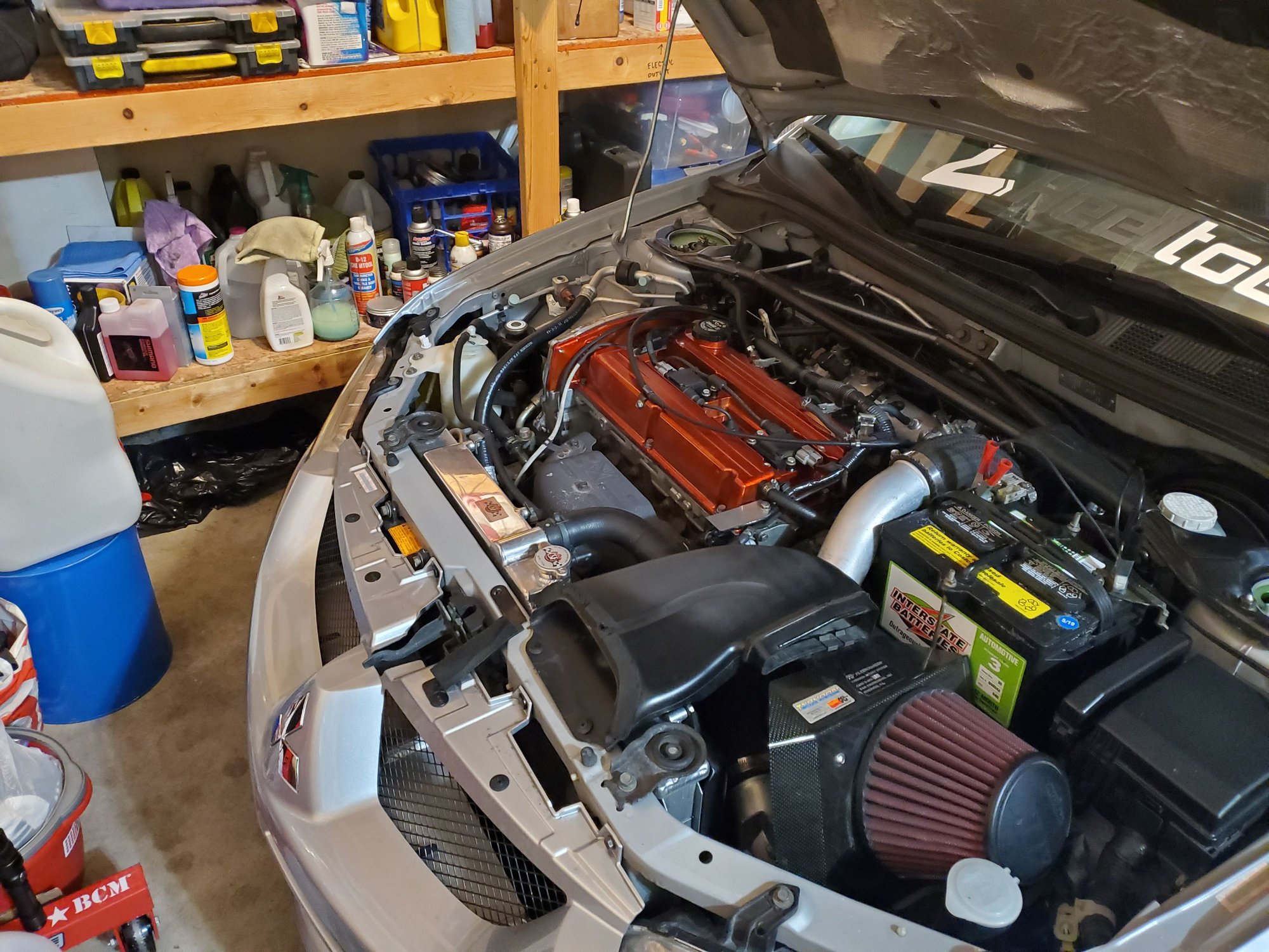

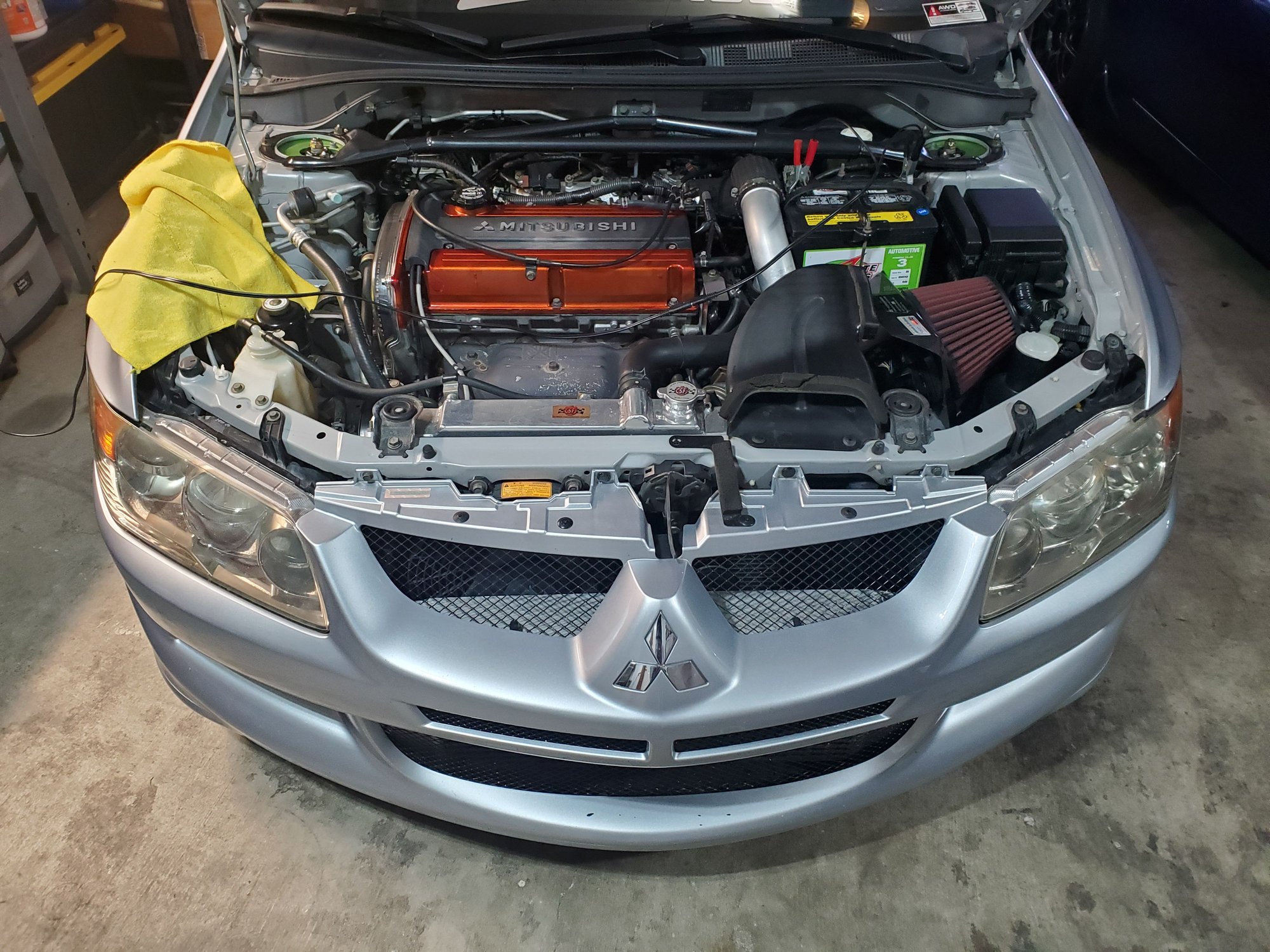

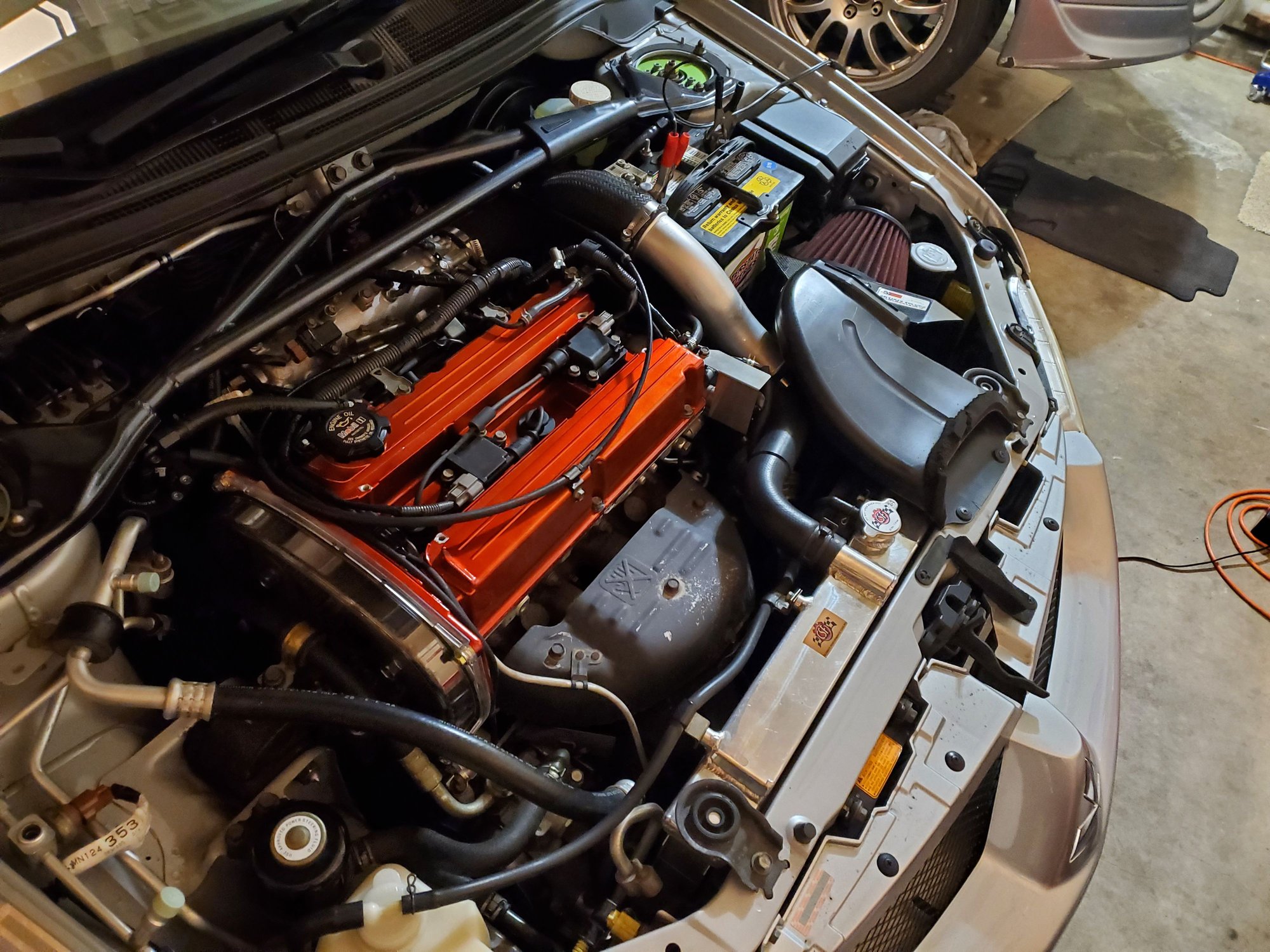

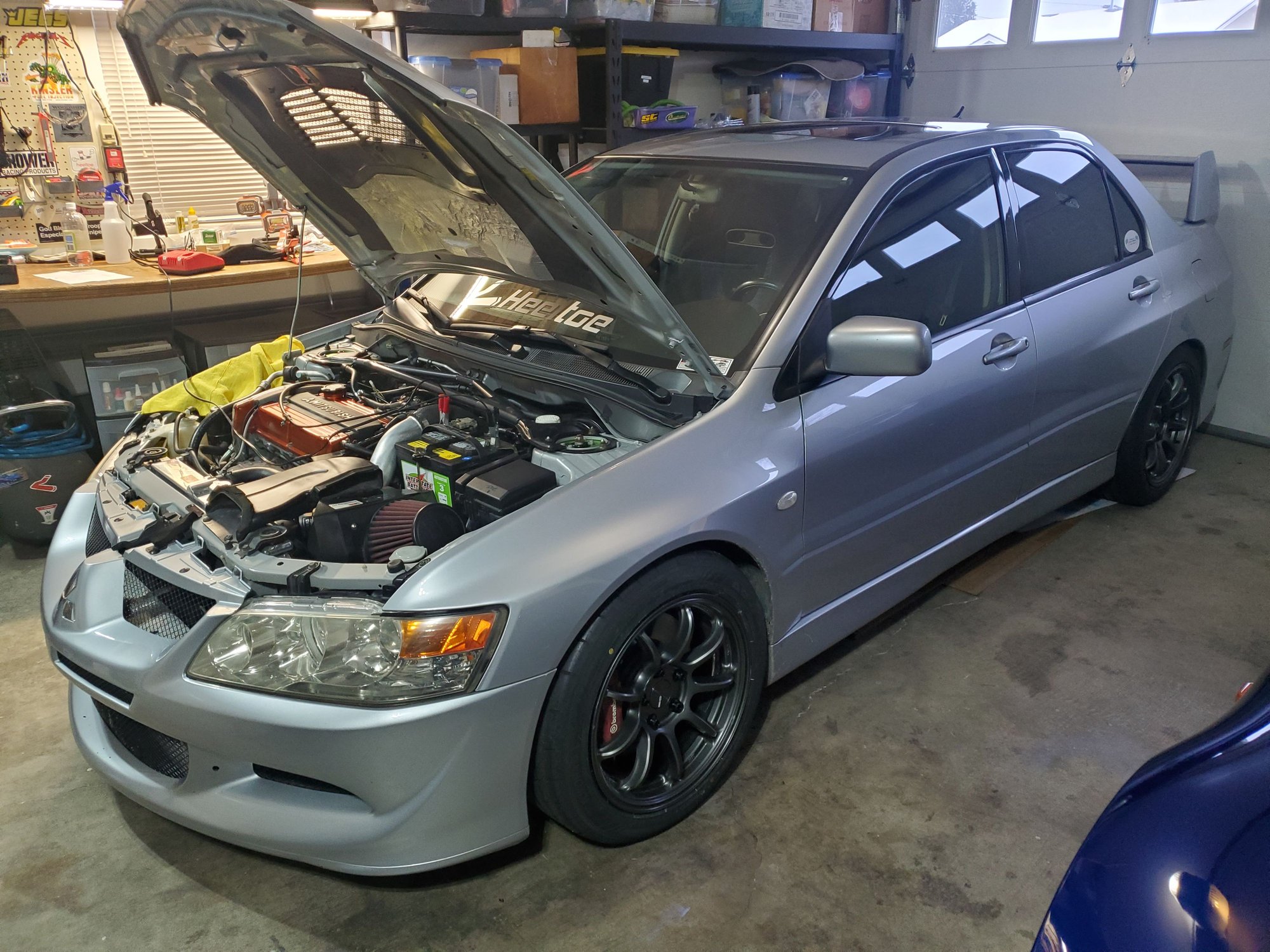

Here's some pics to show how different lighting affects the color:

Dang that looks fantastic. It looks like it has a little more orange/yellow in it than OE but by no means is it excessive. Good job
Edit: looking at it again, that might just be your garage light/reflected light

^Thanks! Yeah, just a bit more orange/yellow in bright light.

Update on my VC. The paint is holding up well, although it's become slightly more orange in direct light.
In the shade, the match is still OK.

I see what you mean about the the orange hue but it still looks great. Probably the closest you can get to oem with off the shelf paint. The PRH which was commonly used on the early Chrysler 300 has a slightly darker maroon-ish hue to it like the oem valve cover paint, especially in the shade. When I get my cover back from powder coating I could post a picture here for color comparison if you're interested.
