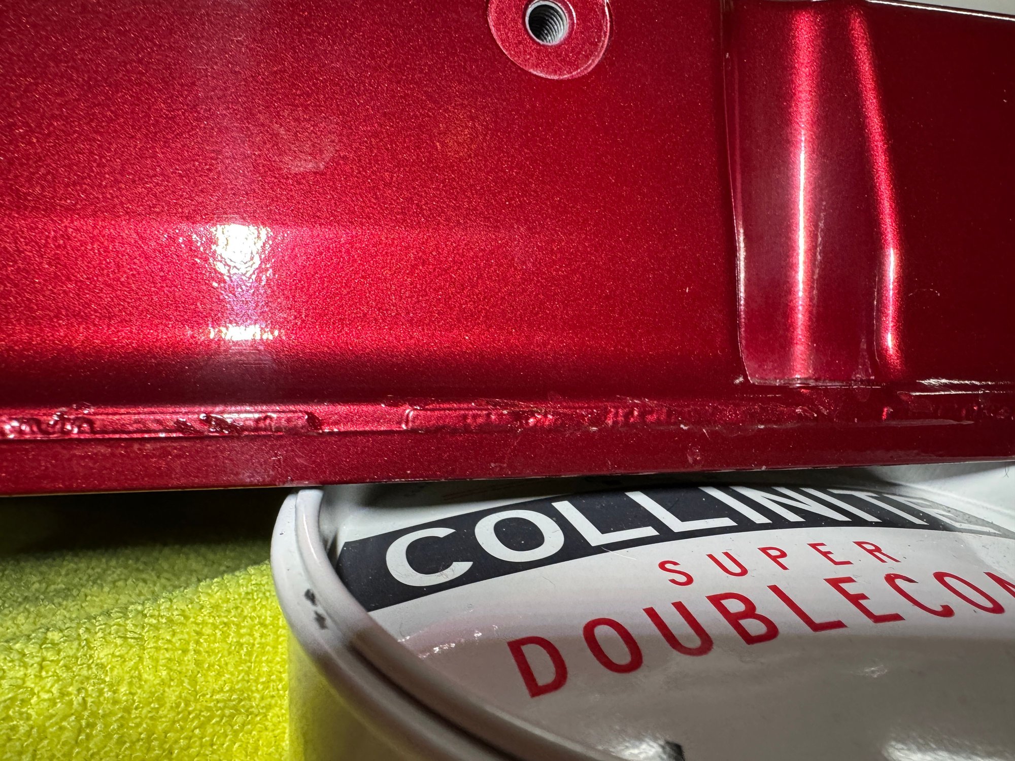

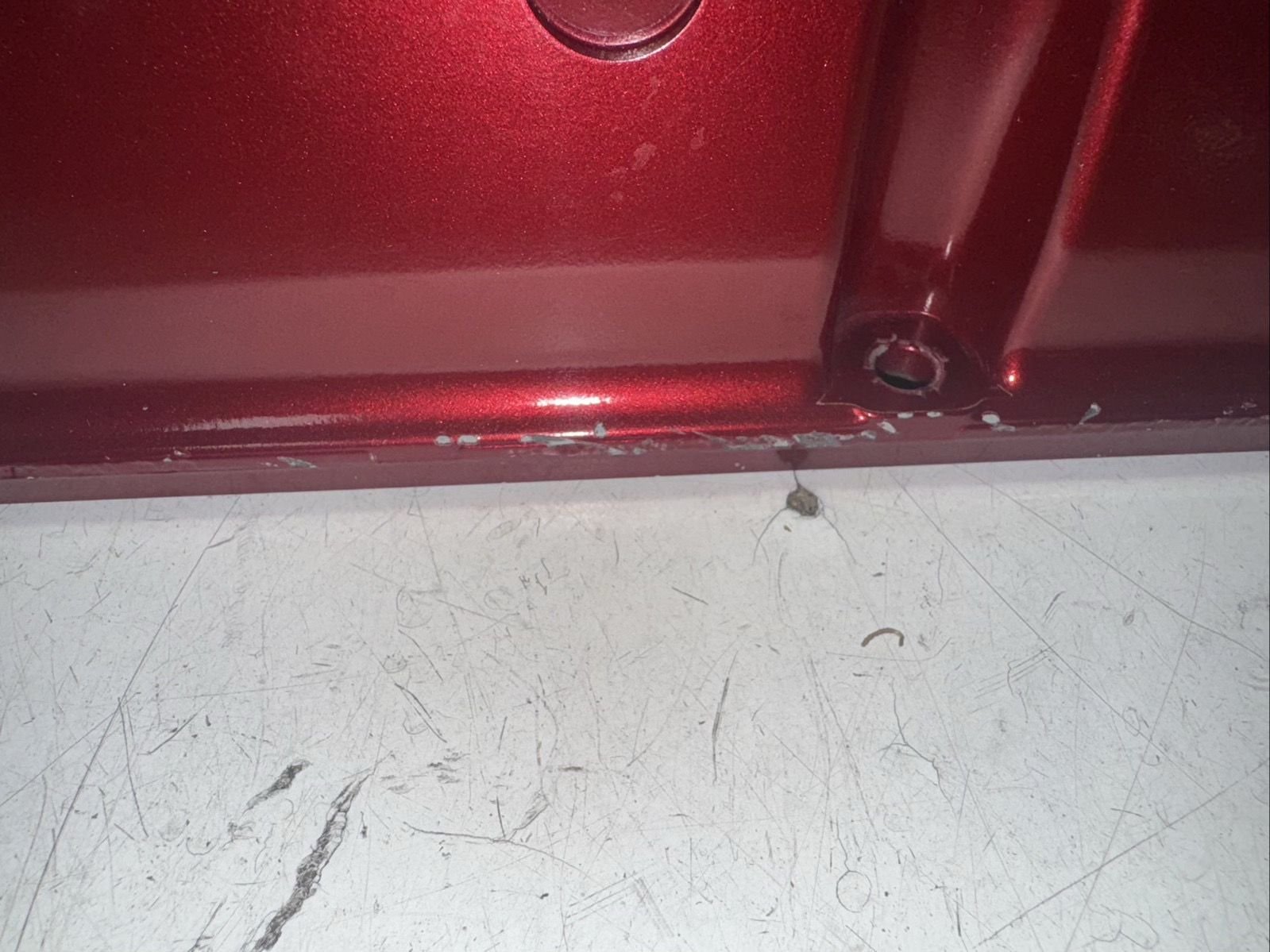

I only used it as touch up paint, so in some angles it appears a little darker, but if you were to repaint the whole thing, I think you would be pretty damn close. Also, it is a 20 year old piece and has probably faded with time too. Pictures below showing before and after - with harsh LED lighting. I did a test spot around where the coil cover bolts on, which is the third photo. Your detective skills paid off for me - thanks brother!
Before:
After:
Test Spot:

To my eyes, it's an excellent match. I agree that the original fades a bit with age/heat.

Awesome, thanks for the pics. 100% match to my eyes. Its settled for me.
