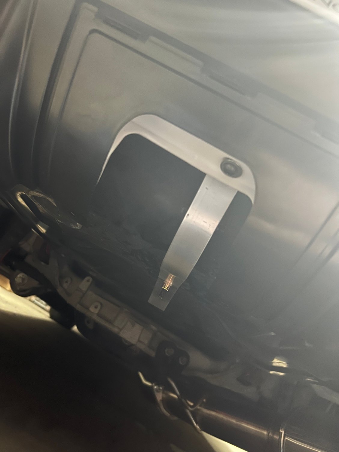

Ordered some aluminum bars off Amazon and crudely bent one into shape to pull the center of the diffuser in more. There’s already a plastic bracket under the tow hook cover so that was the starting point. I mounted a rivnut to one end of the bar and secured it to the bumper. From there I just started bending until I had a shape that somewhat contoured the bottom of the trunk. I drilled another hole in the other end of the bar and used a paint marker to mark where I was going to drill into the trunk. Throw another rivnut into the bar and you can tighten everything down. I’ll probably trim the bar and paint it another day, but I’m otherwise happy with the results.
