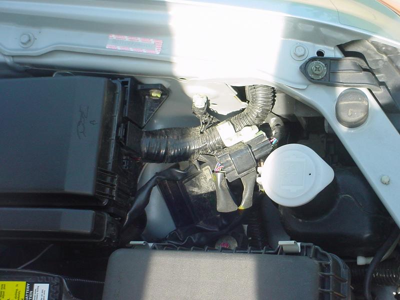

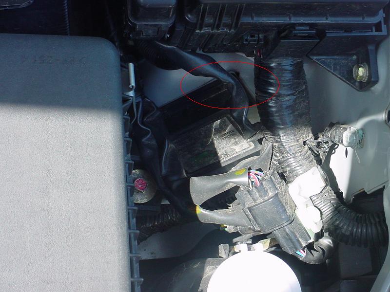

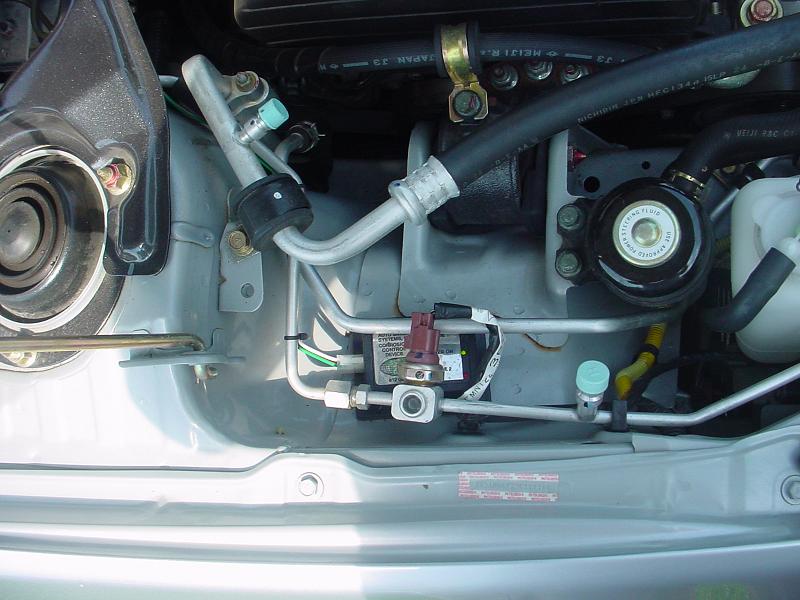

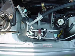

Install Pics
The first pic shows where I put my main controller, a top view of the passenger strut tower area. The second pic shows the remote anode, which is on the driver's side strut tower area. It barely fits. The third pic shows how the very corner of the anode isn't completely stuck down (red circled area), but the actual anode element is completely sealed, so it's okay. These were the best easy locations I could find -- there aren't a lot of flat surfaces on the sheet metal. If you're willing to dig deeper into the underside of the engine compartment, you may find other locations.
I ran the wiring zip-tied (and hidden underneath) across the strut tower brace. About 1/3 over (but still on the passenger half of the car), I branched off and used a convenient ground stud there on the firewall (I soldered ring terminals on to both power leads). I ran the 12V feed right off that box on the positive battery terminal. I coiled up the excess white wire (for the remote anode) and stuffed it neatly underneath the fuse box on the driver's side.

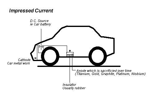

there are 2 types of Impressed current systems.
Local anodes
These are attached directly to the surface (but Insulated by a stand off, usually rubber) See diagram attached
Remote anodes
Placed a suitable distance away to provide an overall blanket type coverage.
(opposite corners of the vehicle)
Remote anodes
