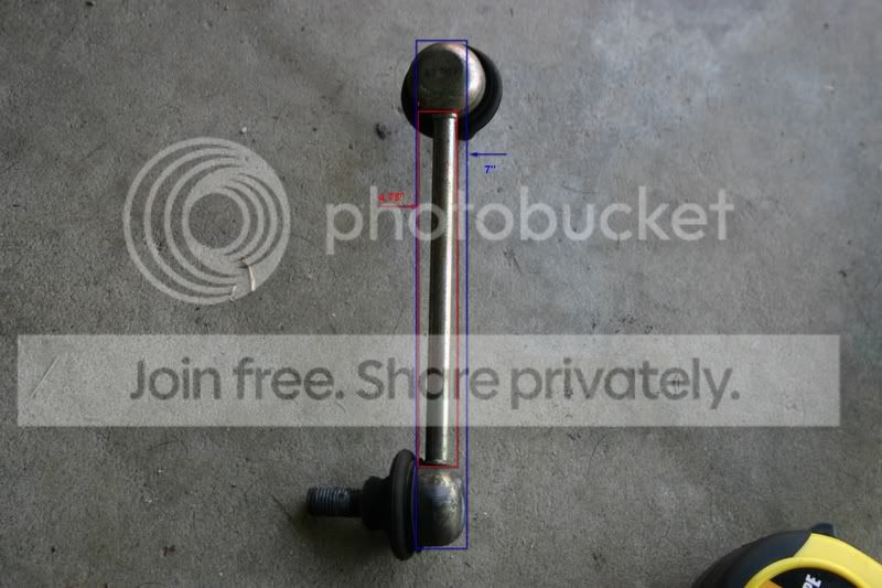

I finally had a chance to remove the endlinks and measure them. Here is a pic...
the red font shows 4.75" and the blue is the full length 7".

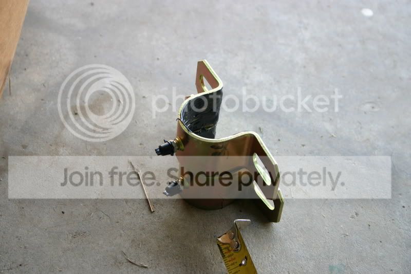

I also installed new brackets from ES with nipples to regrease the damn things..

thanks for doing this, looking forward to the end result!
