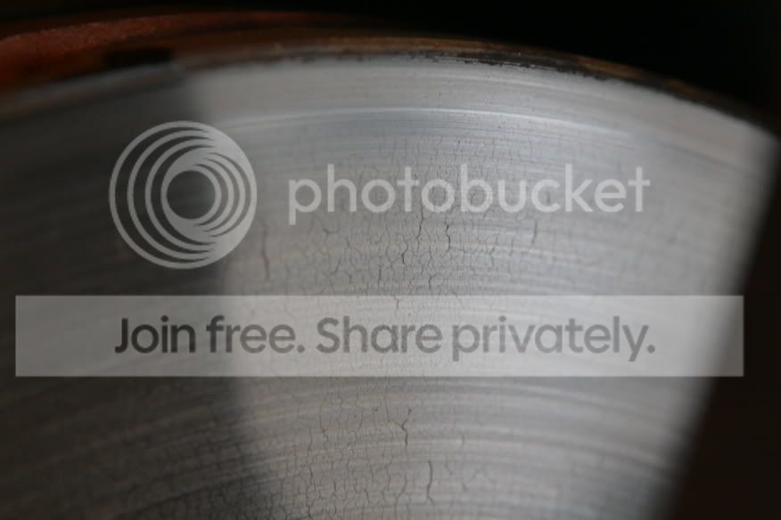

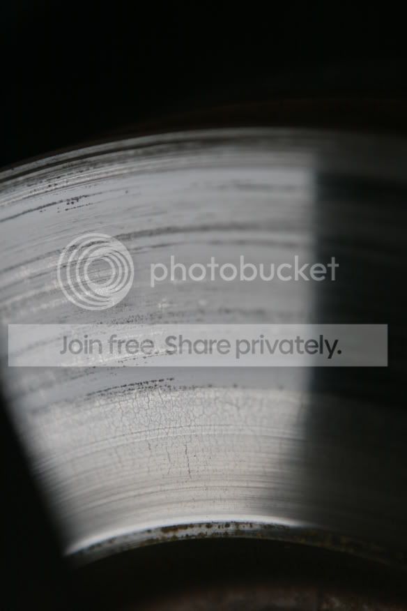

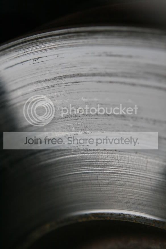

Guys i need your opinion.
5 track days, 20k miles on DS2500 (3 days)
Front Stock Right Rotor - Hairline Cracks
Front Stock Left Rotor - Hairline Cracks and Weird Wear
Will these last 2 track days on Raybestos ST43 pads w/ Ti Shields and Motul?
I want feedback and opinions from people who ONLY track their car HPDE/Race/TT.
I do not want to change out hot rotors at the track. Just seeing if i can get my money's worth out of these.
Other things to take note...Thunderhill Raceway Willows, CA
One 125mph - 85-90mph braking zone
One 115mph - 40mph braking zone
One 115mph - 60mph braking zone
Mods in Sig. Tires = Toyo R1R 255/40/17. ~3260lb race weight.
Again, will these last back to back track days on Raybestos ST43 pads w/ Ti Shields and Motul?

I would run them for 2 days yes, the cracks are very shallow are nowhere near the edges just be sure to check them after every session.

Sure rotors are cheap but you have to draw the line somewhere or you'll never get out of the driveway.
Those rotors are not close to failing.

when i lightly drag fingernail over the cracks, i do not feel it. Do not feel any bumps or resistance. Don't have a "lip". Probably not even .5mm. Thanks guys.
