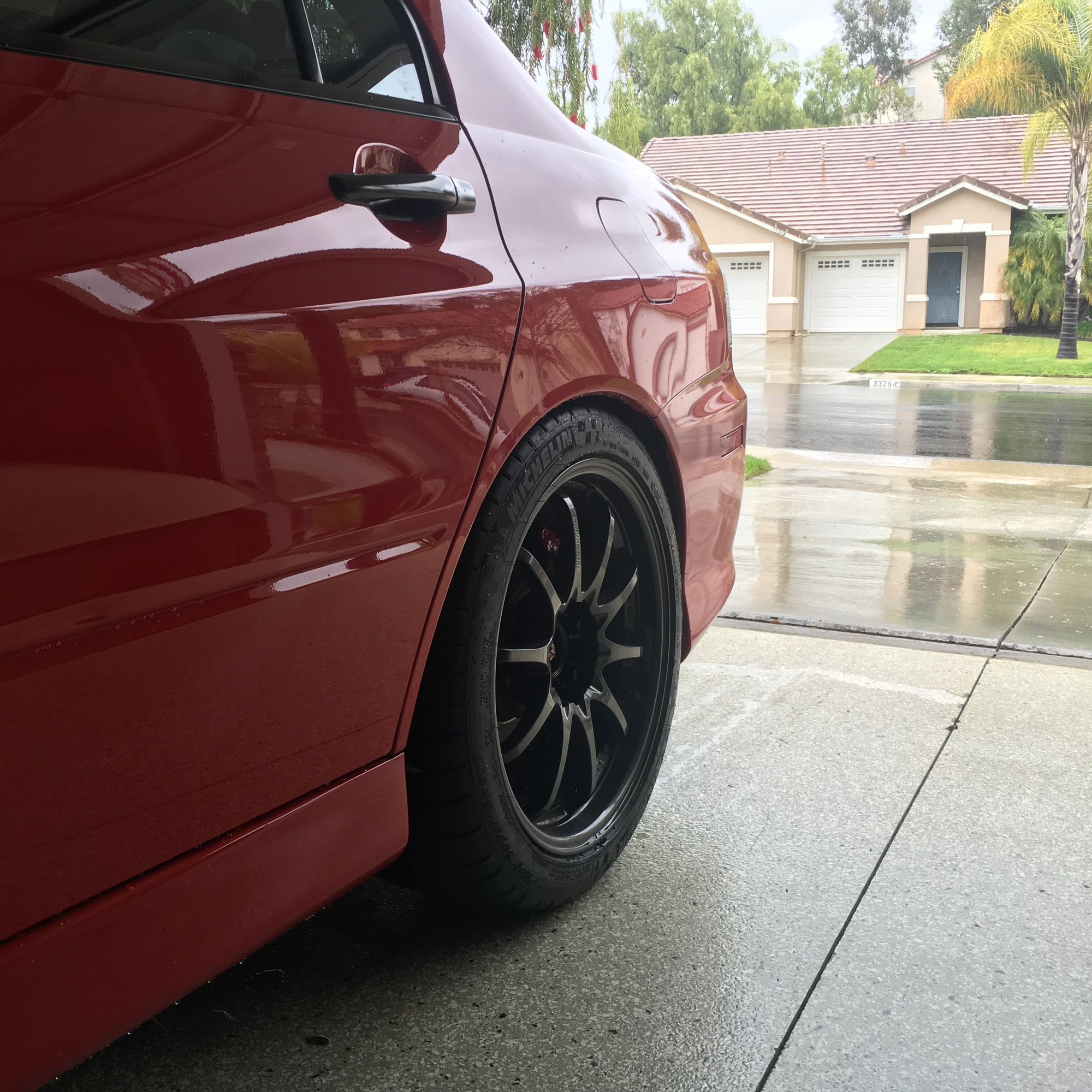

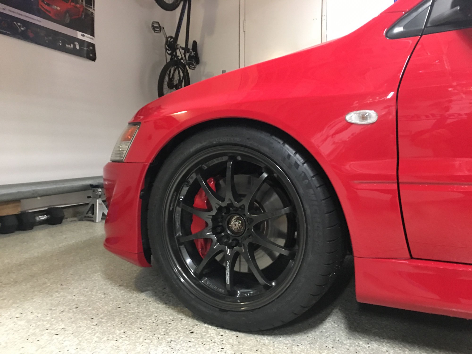

got the CE28RTs (18x9.5) PCd in a color called Galaxy Grey 3. They turned out great. Also put on new Fortune 500s and freshly rebuilt and PCd Brembos. Unfortunately, due to a miscalculation on my part with the front spacer on the Volks (these are an odd +24 offset which were only released in this offset to my knowledge on this version of the Ce28), I had to order an additional set of 3 mm spacers to clear the fronts. Soooo... effective offset on the fronts will be a tad aggressive at +16. But the rears fit just right. The +24 made a world of a difference. Went with 265/35 Potenzas. A couple of pics to show the rear and new color of the wheels. This is without any camber or alignment of course.

Teaser pics Roger
Need some backed-off pics. You know, that rear 1/4 shot looking fwd
Congrats
