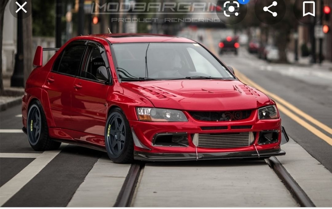

Originally Posted by Insanity Evo
Hi. So I will start this off with saying I know very little about wheel fitment and using spacers other than 17x9 or 17x9.5 RPF1 is usually run with a +35 offset and 20mm spacers lol.
Anyway, I am looking to purchase a set of momo wheels. However, I do not know if they will fit or what offset I will need. I am looking at either 17x9 or 17x9.5.
https://modbargains.com/momo-heritag...-inch-5x114-3/
Those are the wheels. I am wondering if these would fit or what size spacer I would need if I go with either 17x9 or 17x9.5. I see they have the lip sizes listed, but I'm not sure if this is the same as offset. Also I am not sure what tires I would run.
Would any of you wheel experts be able to help me with this please? Below is a picture of the wheels on an evo.
This is the type of fitment I am looking for
Hello. The pictured EvO has over-fenders so the look of the wheel will be different than what can fit on a stock body EvO. Those pictured wheels could be 18x10's plus
I run both a 17x9 & a 17 x 9.5 setup. It really depends on how much rear fender work you can stomach?
Let me know if you are open to rolling & pulling the rear fender (should be done by wheel & tire shop)
Cheers,
Thanks for the quick response. So I don't need that exact fitment and would prefer 17x9 or 17x9.5. Do you think I would still need fender work then?
Otherwise I might just go the standard RPF1 route. I was just trying to do something a little different going with momo.
That Momo fitment in the pic will certainly not fit w/out over-fenders. I like your idea of doing the 17x9.5 RPF1 (one of my favs). That setup is the +38 offset which, as you know, requires the 20mm front spacer.
Running the +38 in the rear w/a minimum tire of: 255 or 265/40/17 will require a nice, flat rear fender roll to start. The front fit will work as the front is much more forgiving but expect some wheel liner rub! The effective offset up front will be an aggressive +18 due to to spacer
If you want to try something else, just let me know the wheel & tire size.
I'm interested in these wheels as well but I can not find any info on if they'll clear the front brakes and the stock fender with a square setup. Also, ideally not needing spacers...
Without speculating, does anyone KNOW of these being run on an Evo 7/8/9?
The modbargain pic looks photoshopped and it does say "product rendering" as well as having the over fenders and being staggered.
https://www.summitracing.com/search/...color%3Ayellow
