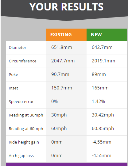

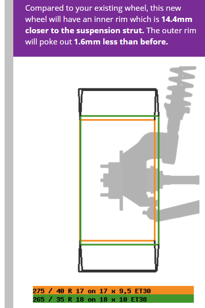

I would run the 265/35. Heres is an overlay between my setup 17x9.5 +30 running 265/40's vs your idea of 18x10 +38 running 265/35. My overall circumference is a bit larger than the 265/35 so the 30 series tire would be not be my first choice
Ive been running Federal 595's & i really like them in the 240 tread wear. Feds do run a size wide so a 265 is more like a 275 in section width. I currently have 2 sets of these tires & would buy again

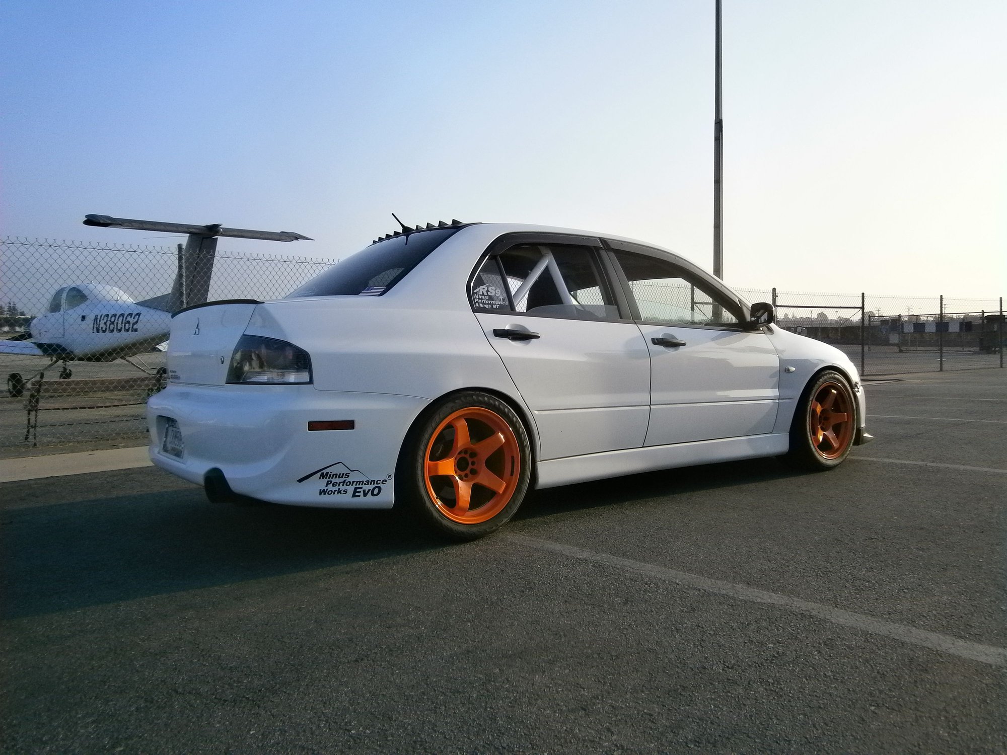

Well, That 18x10 +38 really does fit but keep in mind: Serious rear fender work is needed. Look at my setup: 17x9.5 +30 running a 275 wide tire. This required a rear fender roll, Rear fender pull, bumper bolt relocation, removal of the plastic rear splash guard & a few other little tricks. Are you Ok w/that type of work?
Ive been on 17's since the beginning but 18's do look better in some cases. 17's have to be on the aggressive side both offset & tire width to look good IMO.
Let me know if you have other questions / Joe
Heres my ride for reference @Boostindsm22

can you post a picture of your car MinusPrevious just wana see how 17x9.5 look

cars looking good , ya im ok with most of that work im just wondering is 18x10 fit better then the 18x9.5?

Well, the issue w/the 10's is that it gets you closer to the trailing arm, but the SSB arms correct that issue. The 10's in the +38 actually help in regards to the poke. Those 10's are 1.7mm more inset vs my setup & that helps a bit w/fender clearance. The 265 tires helps as well as there is just a bit of stretch vs what i run
Just so you know, my set up has zero rub as i use to track this EvO & tire rub can not be tolerated
