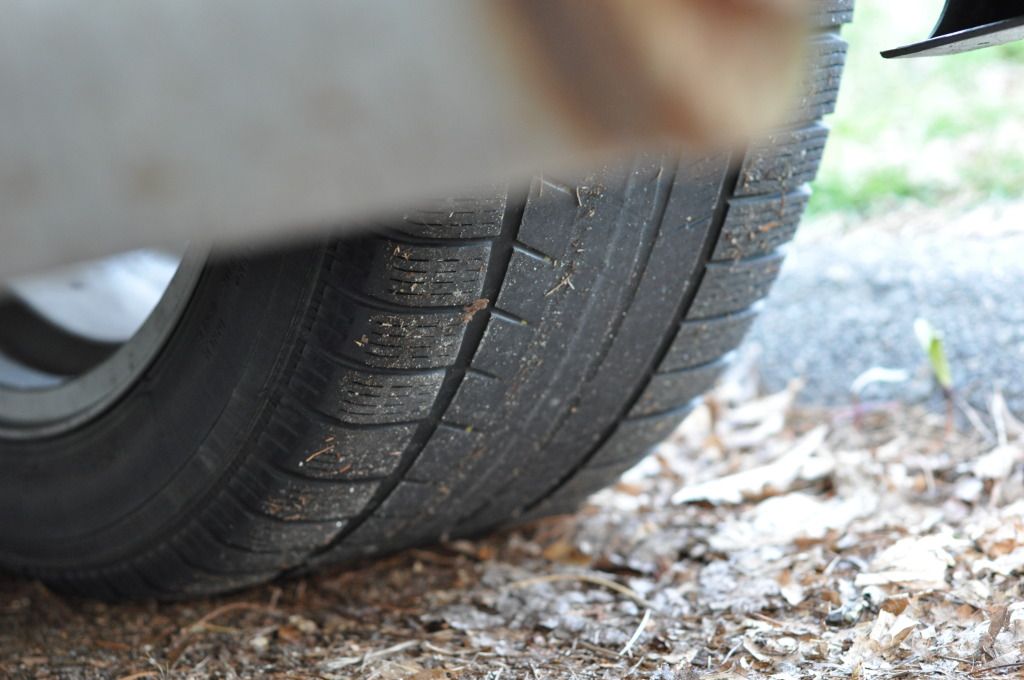

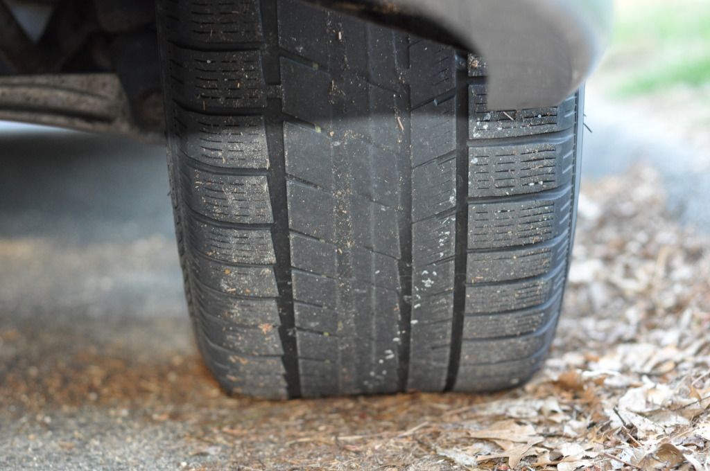

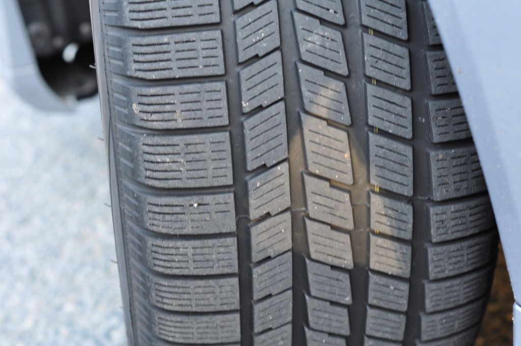

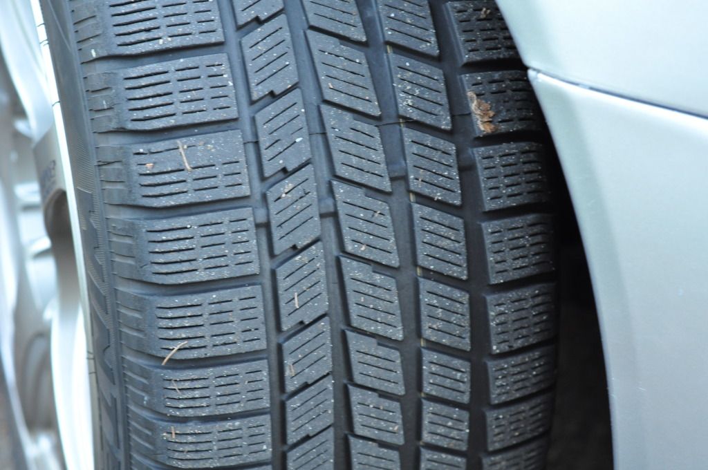

Driver Front
Drivers Rear
Passenger Front

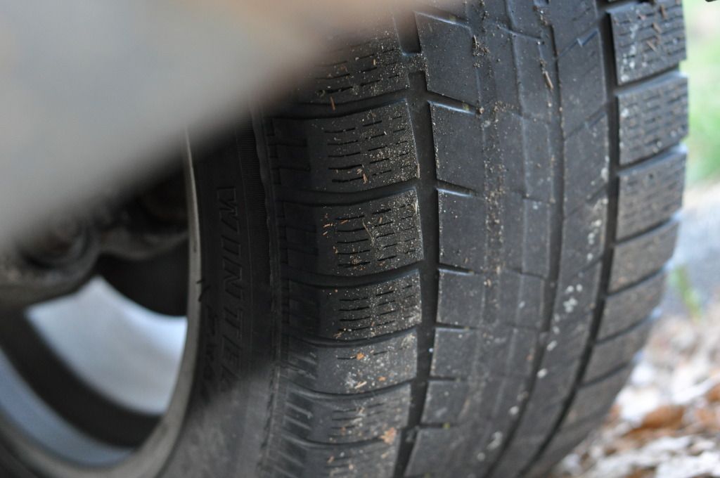

NOW ON TO THE PROBLEM
Passenger REAR
Then I drove foward like some people requested to show its not just a flat spot

How many miles on the tires? How many miles passed since last time you checked tire pressure and when you first noticed this? You may have a defective tire that is rounded. If you have sufficient proof of an good alignment and that you maintained proper tire pressure, then I would think you are due a new tire. If you toe was bad it would affect the entire width of the tire, not just the middle.

Toe. Look at the center:
http://i222.photobucket.com/albums/d...r/DSC_1649.jpg
Its feathered outwards.
And 30 psi after a 25 min drive appears low. Should have gone up a few more psi with heat in the tire.

If your toe was ok since last align (you said dec 2011) and that tire looked like the other three around that time as well, I would say its a factory defect. Potential issues are crown radius is too high (round tire), tread center gauge too high, or possibly base compound gauge too high resulting in very fast wear in center of tire.
Smike, you think any of these are culprit? could be a hopper loss on a cold feed extruder?
If it were me I'd be trying to get a replacement tire and have it shaved.

Smike may be right but I'd expect to see wear from toe all across the face of the tread and especially at the edges. I wish I could feel the tread. A toe problem will round one edge of a tread block and the opposite side will be sharp edged.
I say bad tire.
