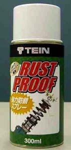

Also, TEIN used to offer "Rust Proof"spray, but pretty hard to find these days. I believe that since they started using the ZT coating they haven't felt it was necessary, hence the disappearance of Rust Proof.
